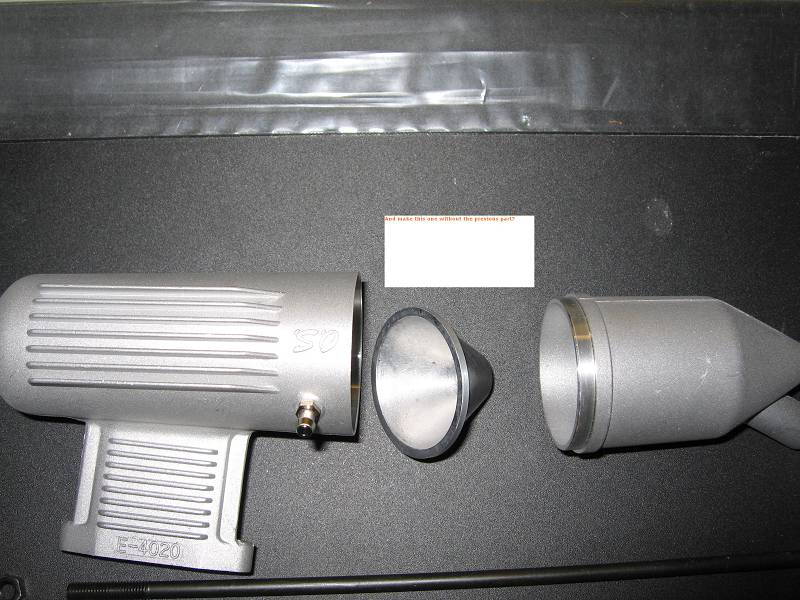

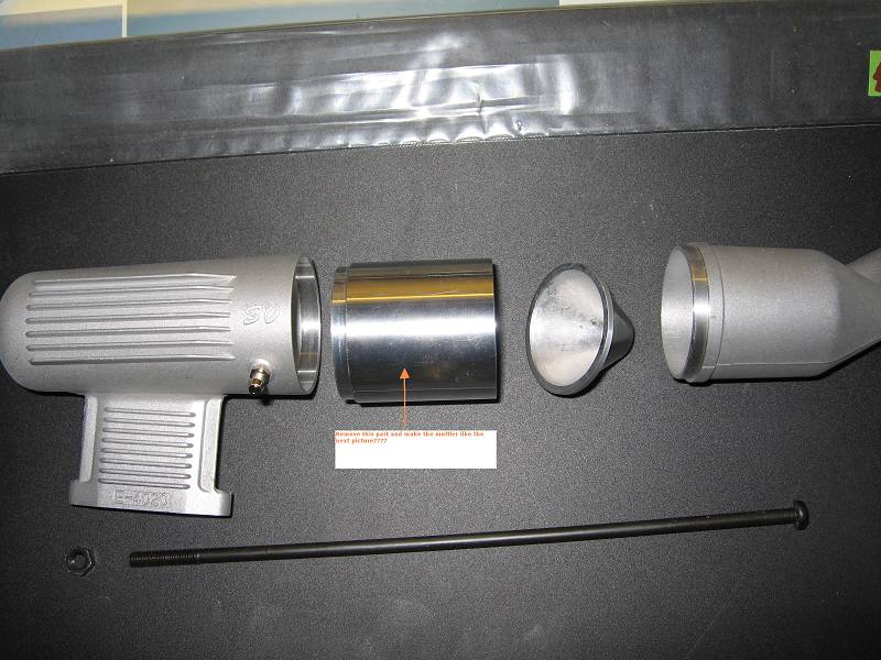

Yesterday i tested my OS 91 FX so as to see if it fits in the cowm of my Corsair.
Unfortunately it wasn't.
The reason is that the muffler has a part that adds to the overall length.
So i thought if i can remove it and use my engine without it.
But firstly i would like to hear some oppinion from the experts of the RCU forum.

Hi! I asked about this in the OS support forum and Bax said that it would make the volume of the muffler too small and he advised against it.

A pitts style muffler from bisson or slimline will solve your problem.
this engine requires a good back pressure so i wouldnt mess with the stock muffler.

I agree....the muffler with the center section removed would work OK
on a .60 size engine. It would be restrictive on the .90 without it.

I bought my .91FX about 3 years ago and at that time did not exist a muffler with this center section.
I flew with this short muffler and had never problems, my FX turned ~8.600 RPM with APC 14x8 and CoolPower 5% fuel.
I think it wouldn't be a serious problem when you take this section out.

kostas, just try it and if it is to restrictive, if the engine overheats or is weak you can remove the baffle and open up the outlet a bit to "derestrict" the muffler. I run the 91 fx with these mods even though I have the mid section in place and it made my engine a whole lot quicker to spool up my prop.(wasn`t to impressed with the performance in stock form) have no tachreadings before and after, but it certainly has more power now and no issues. trottles fine, runs great and never a deadstick as long as there is fuel in the tank

OS does make 1/2 inch extensions for the muffler. Been there , done that

I've already ordered one of these extensions (35mm) and i will have it in some days.
So until then do you have any other option for this darn muffler?
