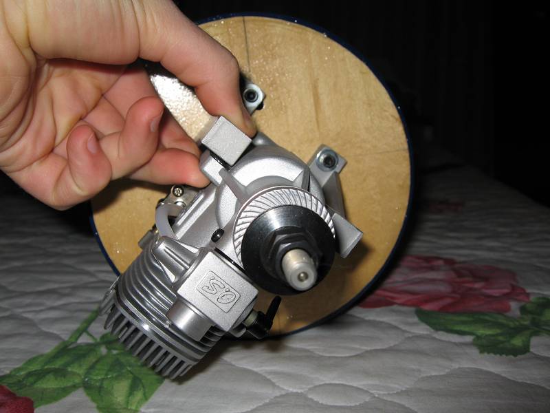

I think the best you can do try if your engine is overheating is to run it full throttle for 3-4min. on your 3d plane.
If it is overheating and there is nothing to do with the cowl(...),order the replacement backplate and needle valve assembly.
I bought mine a few weeks ago and it has the replacement parts on it.
I haven't try it though to see how it works.
I think it will be fine!
Enjoy.
Kostas

Maybe you can rich the high speed needle valve a bit.
Also i think the replacement parts that OS provides now are solving many many problems.
