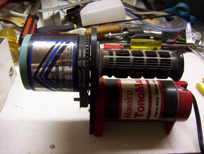

This is my version of that that, this starter would not start my Saito 1.50 using a 275 AMP garden tractor battery, I put the Miller 4to1 reduction on it and now it starts my G45 with ease.

A reduction drive also allows you to use a lightweight low capacity 24v battery. Direct drive would require a heavier battery.
