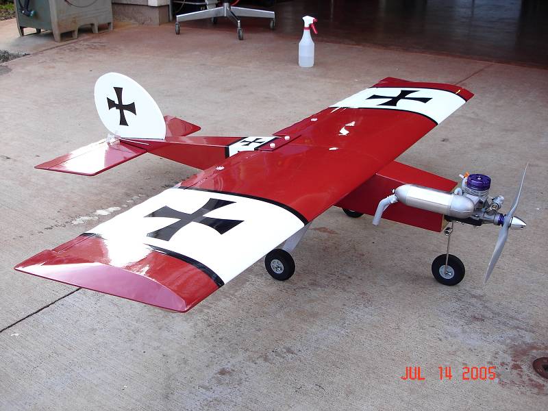

I'm using this engine on my first plane, GP Big Stik .40 it has a lot of power but not reliable, my problem is the engine keeps dying on me. Not very confident with it, I'm sure it's just my needle setting. I like doing low fly bys and usually the engine dies when transitioning from idle to 1/2 throttle. Luckily I'm right above the runway when it dies and I can save it. But my last dead stick, the wind was blowing hard had to turn the plane around didn't reach the runway and it went to the trees. Just a little tear on the wing. On the bench there's a good transition and everything seems fine. I'm using a 12 x 6 APC, tach it around 11,800 RPM WOT and idles around 2,600. Vertical is insane. I stop using the Tower plugs and switched to OS 8. (got free plugs with this engine). Since then I had about 3 flights now with no dead stick. Keeping my fingers crossed. I almost gave up on this engine and was going to put a 4S in. But I'll give it another chance....

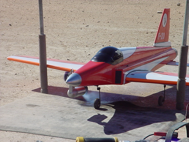

I run my Tower .75 for every RPM and ounce of power it will produce. I run
it on 15% PowerMaster with a dash of extra castor, and a K&B 1L plug.
The best speed I can get out of it is with a MAS 11-7 1/2, at 14,000 RPM's.

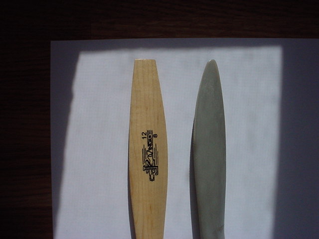

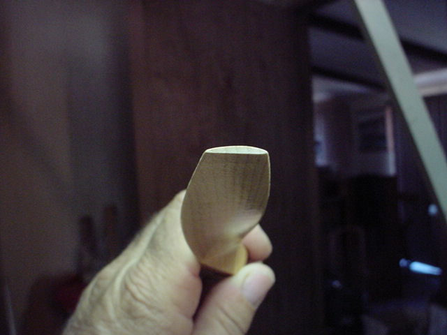

Zinger props have an airfoil shape at the tips that produces thrust, and
pulls the plane forward. The tips of the prop are moving at the highest
speed. The APC props have little or no thrust at the tips. They are designed
this way to be a "quiet" prop.
A "quiet" prop is great for quiet, but not for speed. This is why the Zinger
whoops the APC for speed.

Look at this picture again....look at the shadow under the leading edge
of this prop comparison. See how the APC has an exaggerated angle
from the hub....out to to aprox 2/3 of the blade ? This is where they
produce their thrust....this is also where the exaggerated angle robs
the engine or RPM's.
Now look at the silly tips on the APC. It is made this way to reduce noise
certainly not to increase performance. Good speed props, like the
Zinger's not only give more RPM due to the design, but give more thrust
and speed to the plane because the tips are turning fast and producing
thrust.
Why people think an APC prop is the best....I have no clue. An Internet myth
I suspect.

I do not argue about the actual speed result achievements of the straight-tip Zinger, like the one in your photo.

It doesn't have to be a perfect Clark-Y....the convex side opposed to the flat
side will offer the desired effect in any case. If you look at the pic I posted
again you will see that it is clearly airfoil shaped....
....designed for maximum speed/thrust at the tips.

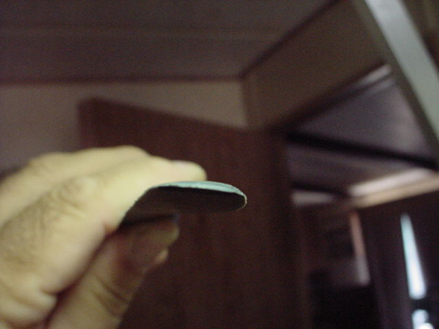

Look at this Master Airscrew tip....same story, airfoiled shaped....more speed.
