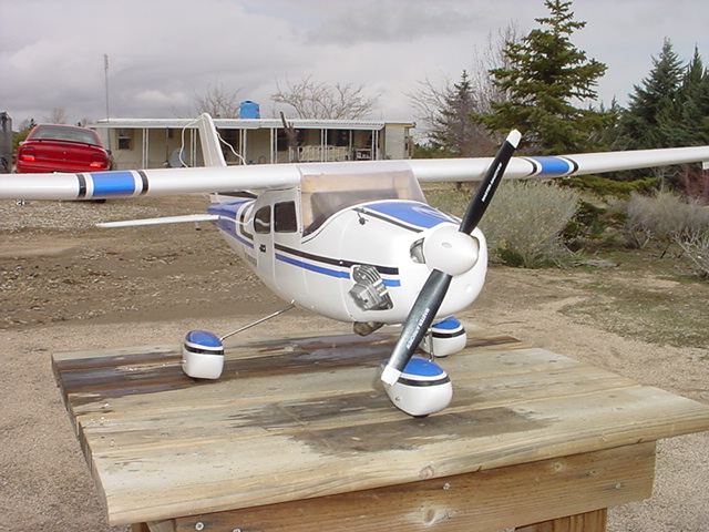

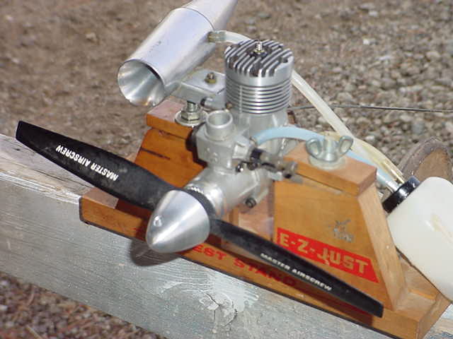

I'd use 10-7 Master Airscrews on it, and spinner nuts like this one.
I wouldn't use three bladed props until I had the plane completely sorted
out. I found that three bladers are not as efficient as a regulat two blade.
You don't want a twin hanging on the props. [X(]
FBD.

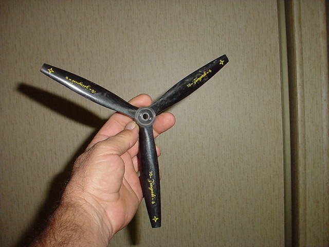

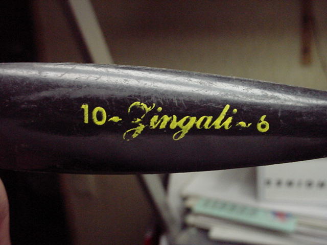

Here it is....a Zingali ????[sm=stupid.gif]
I think I had a special three blade spinner on it too. I think the Guy that
sold me that junk still gets a chuckle out of it from time to time.

LOL, too much flex with that prop? Though 3 blades are less efficient, the differance is just a percent or three. Not enough to cause it to almost not fly. A 10-6 three blade is a bit light for a K&B .61, coupled with too much flexing, could have been the problem.

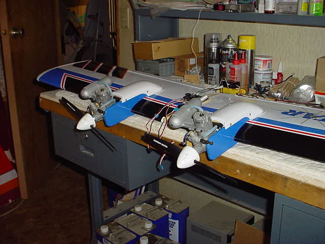

....here's a good test plane too, but it flys too good with the 12-8.
In fact, it's way too fast....maybe a doggy three blade would be better.
