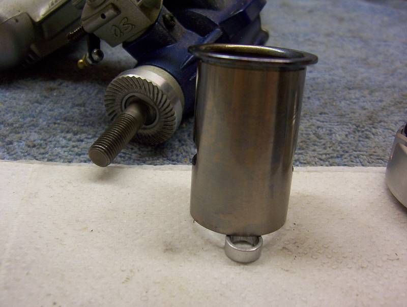

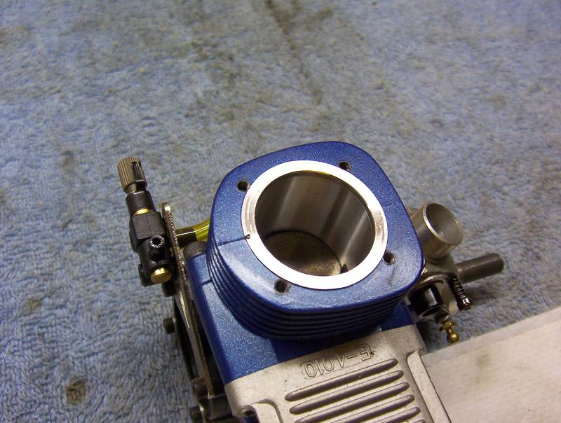

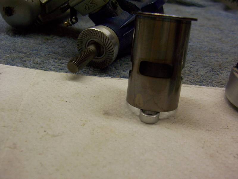

Picture #1 is the front of the cylinder, the exhaust port is barely visible, poor picture taker.
Picture #2 is the back, there are only two intake ports.
Picture #3 shows the exhaust port which is canted about 45 degrees CW as are the intake ports. My particular LA .46 has a third intake in the back of the liner but there is no corresponding passage in the crankcase.

What are you going to prove us torque wrench,with these pics?[&:]

Dave,
I don't understand...
Why would OS bother to make an expensive extra port, it they don't bother to make a corresponding bypass...

What he is suggesting is that your LA, with a single transfer port & a single boost port, is probably not a good candidate for a pipe -- which was previously noted.
There is some problem with your engine that is limiting its output. We don't yet know what that problem is -- but a pipe won't cure the problem.
Is the cyl head sitting squarely on the block (not cocked) & have you checked the cyl head bolts for tightness? Have you checked the back-plate for tightness? Is the carb firmly seated & sealed at the base. Does it idle smoothly & transition smoothly?
Have you looked inside to see if a casting flaw is partially blocking a transfer passage? Is there a piece of machining swarf in a transfer passage?
Is the sleeve installed correctly (not backwards) in the block?

The head being cocked, it happens, I fried the piston ring in a black Merco .61 because of that very thing. Like a Moron I gave it to friend who discovered the head being crooked and got a ring from Frank Bowman and now he has fine engine that he flies a lot.
His cylinder liner should be lined up OK, it has a cold rolled steel pin in the block that indexes a notch in the liner phlange.
Dar, I will look and make sure this is the case.

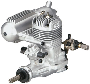

Patrick,
The port arrangement in OS LA engines is such that the transfer ports and the exhaust port are angled, in relation to the engine's center-line.
I.e. the exhaust port is not straight to the right of the engine, but to its rear-right.
The transfer bypasses are rotated accordingly; rear-left and front-right.
Although the outside of the casting (see photo, silvery engine) shows a bulge where the boost bypass should be; at the front-left, Dave says there isn't such a bypass...
So it is only two transfer ports; not one plus a boost port.
