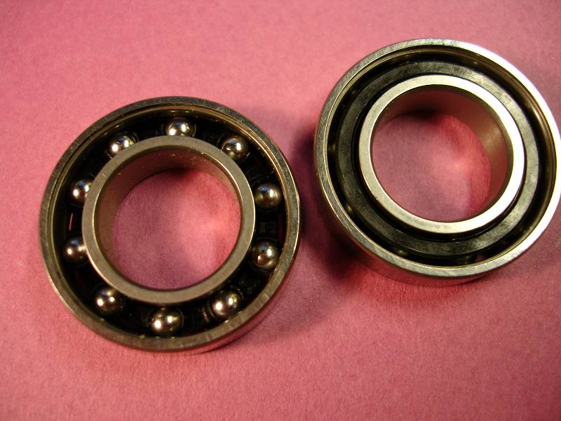

well i have got quite a few hours of use out of my supertigre g-51, starts first flip and spinns a 12x4 at a respectible 13,500 rpm. i have noticed a leak in the front of the engine. the only thing i can think of is the bearing because that is the seal for the front end. its not a terrible leak, when it runs thier is a small drip about every 5 seconds or so and when i let it sit for a few hours i find a small puddle of fuel under the engine. nothing too bad, just a little annoying. my second questian is what i could do to the engine to maybe make it perform better. im running 10% fuel on a #8 plug. are thier any "aftermarket" parts i could put on it? or just any general tips or tricks to make it get a few more rpms would be appriciated. thanks for all your help in advance.

Hi!
A rubber seal or any other seal is not helping in this case. The leakage is due to the fact that the inner crankase to crankshaft surface is worn out or made with too large tolerances...no steel or rubber seal will fix that!
Remember the rubber/steel seals on a ball bearing is made to prevent dirt getting in or holding grease in...not holding glow fuel in!
Picture shows open, C4 bearings from Swiss company WIB the size all .40-.49 engines on the markert use (28x15x7mm) except Rossi.
Regards!
Jan K
Sweden

My Feedback: (11)
With model 2-stroke engines, some leakage is absoutely NORMAL. If you store your engine nose-down, then all the fuel residue/after-run oil in the crankcase will wind up either dribbling out the carburetor or through the front bearing. That's why I've always tied a rag around the front of the engine where the drive washer meets the case...or made some other arrangement to catch the drips. If anybody thinks these engines should be "dry", they need to spend a LOT more time working with them to learn about how they work.
You HAVE to have some oil pass through the front bearing to get it lubricated. As was stated in an earlier post, if your engine's running well, the leak's not serious to worry about. If the nose of the model is being wet with raw fuel, then the leak's worth worrying about. If you can just notice there is a leak, then forget about it.
The seal is not made by the bearing. The seal is made by the close fit between the crank and case between the carb and front bearing. If raw fuel is spraying out and the engine's operation is compromised or fuel consumption has gone 'way up, then the crank, case, or both need to be replaced to stop it.
