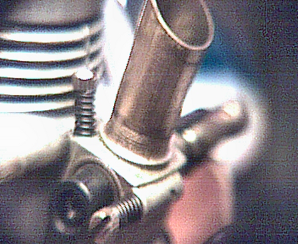

Chip:
Pictures are my first added stack, used to prove the throry. It's on a Magnum 25, it also has the conic shaped protrusion on the intake casting. I just swaged it, you can see the depression around the bottom end, it has not moved since I put it on.
Bill.

A velocity stack is like a tuned exhaust in a way except it relies more on having a long column of moving air that likes to keep on moving towards the inlet valve even after it's closed. This builds up some pressure to help force air past the valve next time it opens. In other words, it uses the inertia of a column of air to ram into the cylinder. Like the old Dodge Ramcharger engines or the Mercedes 300SL used. BTW, that's why the 300SL engine lays over at a 45 degree angle. It's to give room for the inlet manifold length. These engines were tuned for around the 6000 rev mark and used a manifold somewhere around 30" long but our engines run twice as fast so only need a velocity stack half as long which would be...errr...let's see....30 divided by 2 gives...ummm...I'm not sure but I think it's longer than in the photo
Sorry guys, I can't help myself sometimes
But what a stack like those in the photo will do is stop most of the fuel that sometimes spits out the carb. CL team race engines like the Oliver Tiger use a very long stack because they can't afford to waste any fuel.

Brian:
Because of the length needed for intake tuning you will not see me call this extension a "Velocity" stack, I refer to it as an "Intake" stack.
Interesting that the team race boys use the trick, I had never heard of it when I started thinking about having a cleaner and more economical engine.
Bill.
