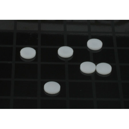

I have had to dissasemble a saito 72. During this procedure, two small round white tabs,for want of a better word, appeard....one even dropped in the crankcase! Anybody any ideas where on the engine they belong?

they are the wrist pin caps, they go in the holes on the piston after the pin is inserted
piston pin retainers is the correct name.

Do they look like this?

Yep that shure is them.Gary, says they are the wrist pin covers,makes sense when you know the answer!! Thanks for the help
