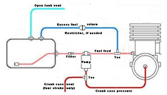

The Perry VP-30 is a great pump. It pumps lots of fuel at a pretty good pressure. You could use one Perry pumps for two engines, and it would work great, and not cost you a huge amount of money. The Perry VP-30 puts out to much pressure for most engines, and that is why lots of people have problems with them. I made the same mistake and could not get my engine to run until I added a return line to the tank as per the diagram below:
Once I put a return line as per the diagram below, my Saito ran PERFECT at all speeds.

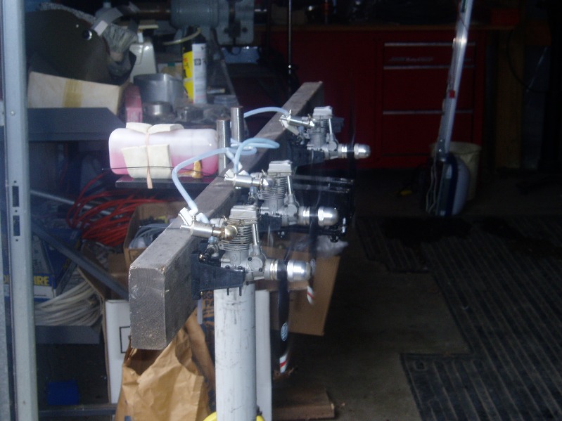

Sorry I have been away from my computer. I went with the Cline regulators. Built a test stand and it worked pretty good. Need to do a little more testing but I think it will be fine. One tank, four regulators one check valve. I even killed the engine prviding the pressure and the tank held pressure with another engine running until I got tired of waiting. Still had to release the pressure.
Old 07-27-2006 | 12:34 AM
DragonLines's Avatar
My Feedback: (13)
Posts: 267
From: Toone, TN
Default RE: Pumps for 4 strokes
A couple of pictures

Might be a good idea for each engine to provide muffler pressure with a check valve in the pressure line. That way you will still have pressure if an engine goes out.
Old 07-27-2006 | 09:56 AM
My Feedback: (13)
Posts: 267
From: Toone, TN
I thought so too, but when I tested it with the engine supplying pressure shut down the others continued to run fine at full throttle. I got tired of waiting for them to die and shut them down and the tank still held pressure. I am going to test it a little more before I install just to be sure.

To Sport Pilot: Obviously I ment achieving these good things (idle, midrange, transition and peak) altogether at the same tunning.
To Jett Pilot: I also added a return line as per your diagram but hasn't worked for me either.
