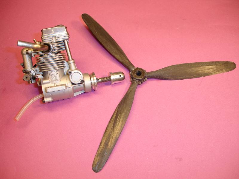

About to finish my parts gathering and I need to purchases a custom 4.75 spinner . So before I get it cut for a 2 blade vs 3 can you please tell me what to expect . I am purchasing this for a saito 180 for a 73" p40 .
Just wondering the range of changes to expect from torque , overall performance , cost , ease of replacement &/or availability of 3 blades vs 2 .

The extra weight of the 3b will dampen the power pulses of the big Saito better than a lighter 2b. You can check out the Graupners at www.hobby-lobby.com under Super Nylon props.

Full scale aircraft use multi-blade propellers to absorb, and make use of the power produced by very powerful engines. They also turn the multi-blade props at much lower RPM,(using gear reductions) with much higher pitch, than a model engine will be able to do.
If you can reduce the prop speed on a model engine with a gear reduction, then you can turn a multi-blade with much more efficiency. Such as with a RCV engines that use a 2:1 gear ratio and recommens higher pitch. When you slow a prop, you need more pitch to get comparable speed. Pitch produces speed, and diameter produces thrust.
I have compared 2 & 3 blade props directly in a model several times. Always need to reduce either diameter, or pitch to get the same RPMs with a 3-blade. As result you will loose either speed or thrust, for a given situation. By increaseing engine power you then run a comparable 3-blade with a as much effeciency loss. That the "real world".

Another reason for three-bladed props on full scale warbirds was to increase ground clearance, especialy when off the tail wheel. Smaller diameter three-bladed versus same effective power with larger two-bladed.
Three blade props are less effecient, but not by much. The loss is from the tip and hub drag of the extra blade. Also more frontal area and drag for the same thrust. But they are also smaller and have less tip speed, even well below Mach I this helps to reduce the losses.
Gear reduced props are only used on the turboprop engines, modern piston engines do not use gear reduction, that was only the huge radial engine airliners of the past.
There are two major reasons to use multi blade props. The first and most common is for ground clearance with a larger engine. The second is for better high speed performance at altitude. For example a large prop will not do as well at high speeds and altitude because it turns a larger column at lower speeds than a smaller multi blade prop pushing a smaller column of air at higher speed. That is why on many GA aircraft you will find that the same plane made for high altitude and presurized cabin will have a turbocharger and three bladed prop, vs the two blade prop for the non pressurized version.

You can and should reduce hub drag with a spinner. You may not get more drag from the tips, depending on prop speed and design. You could end up with less in most situations with the right prop.
You can basically prop any engine for whatever RPM you desire, be it 2 bladed or more. You have prop design, pitch, and diameter to choose from.
Aerodynamically, you do have more frontal drag with more props unless you reduce prop diameter when going from one to the other. That is one reason pattern guys like them for the down lines at idle. Likewise, they like the pull for up lines. A 3 bladed prop may assist in a stable idle. I'm not sure what gyroscopic effects a 3 bladed prop will have over 2 blades. P factor may be more evenly distributed along the fuselage and fin with 3 blades.
The statement that all 2 bladed props are more efficient than 3 or 4 blades is sort of ignoring what a person wishes to do. A 2 bladed prop is not as efficient in the climbs or for descent braking as a prop with more blades. I suppose that a case could be made for a racer needing only 2 bladed props....
