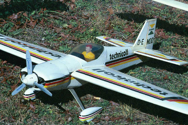

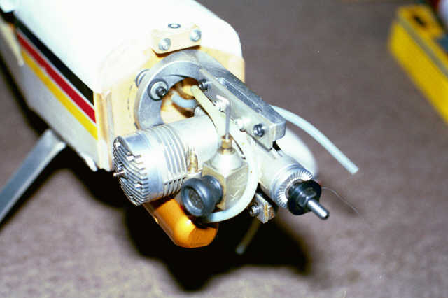

For an example, my Diablo 40 has the same engine you describe, carb and all. I have absolutely no complaint about it. The engine will pull the plane in a vertical take off out of my hand.

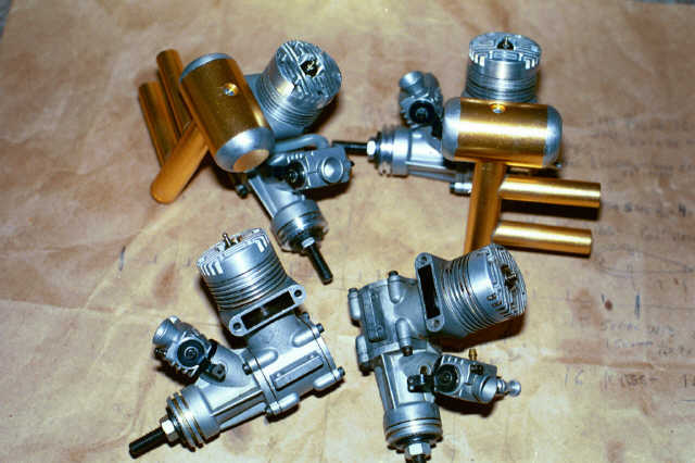

I am currently assembling a new twin with a pair of K&B 6560 engines, these are the same as yours with the addition of a built in Perry pump and a very large bore carb. The 6560 will keep up with most modern Schneurle ported 60-65 engines.

Bill: Sounds like this engine pulls your Diablo 40 just fine. Couple of questions, what does the plane weigh? Were you using the 3-blade when you hand launched it? Also, I see part of a gold colored muffler, is it the stock one, or something else? Have any other muffler recommendations?I have Tower .75 muffler (no baffle), which fits up. Don't know if it will have enough back pressure for the tank, and don't know if the engine timing will like it, any thoughts? Can you elaborate on Clarance Lee's PDP modification. Does he rework the porting or is this something to do with the Perry Pump ?

The Diablo weighs about 5½ pounds, plus a few repairs that have added weight. Actual weight now I don’t know. The vertical take off was with a MAS 12x6 three blade prop. At the moment I have a Graupner 11x7 three blade on it, it’s faster with the Graupner but all round I like the MAS three blade better.
The muffler is special, sorry but I don’t remember the brand. The company is out of business anyway. I do have a pair for the K&B 40 engines, I like them â€specially because they can be easily reversed, just as the K&B 40 engines can, for use on a twin.
The last picture shows how much larger the bore is on the "Pumper" carb, the one on the left.
