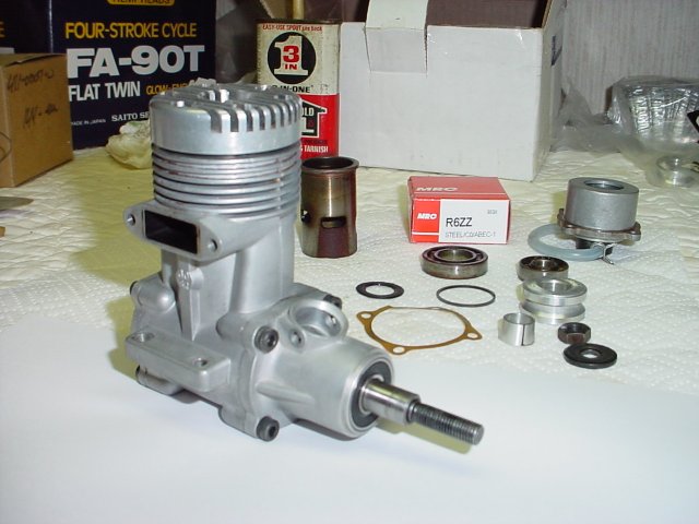

Flyboy Dave, were you frying or baking in the oven? It looks like you scorched the piston, either from not turning it over enough or you had the burner set too high! Soy burns at high heat... I bet you had to scrape that pot out with a Brillo pad!
All kidding aside, what happened? Too lean? No oil??? I need to know, I don't want that to happen to mine! Looks Ugly!

I loaned a used K&B .61 (first mistake) to a friend.
He put a plastic spinner on it, which turned out was
out of balance. The o-ring on the low speed needle
was weak (but ok), and during the flight the needle
vibrated and turned in (lean). He was running it wide
open....and the thing gradually leaned out until it seized.
As you can see....the ring was stuck, and it was fried
BIG TIME. I put a good used piston, ring, and liner in it.
(and a new o-ring)
