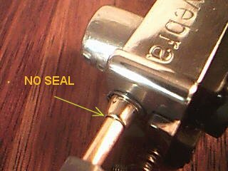

Has anyone come up with a way to seal the mixture tube against the barrel?
These carbs work under pressure and the only way to improve leakage at this point is to buy a new (never worn) tube and barrel assembly.
You nailed it...
