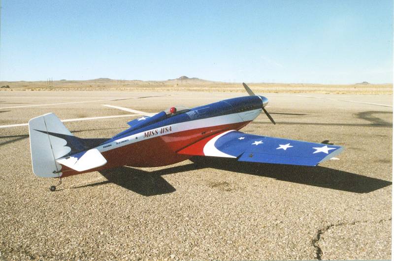

Mine is on the front of a WM GS P-51. Nice flyer. I installed a 24oz tank an a Cline regulator. I put my Cline on just for security and efficiency. Many install these things thinking it will cure the problems they have when it is actually something else. I run a big Slimline Sportscale muffler which basically looks like a set of Straightpipes coming off the head and straight down. I also hooked up a remote glow-again not to cure a problem but just to have it on their.
