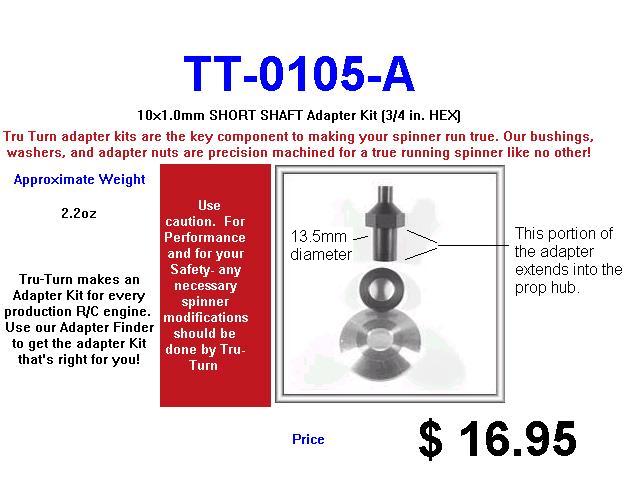

I plan on getting a Moki 2.10. I get the impression that the Moki 1.8 and 2.10 have very very short crankshaft threads. Not much room for the prop nut, especially since some of the shaft is taken up by the thickness of the spinner back plate. I take it, this is what Willy RDRC is talking about. Unless the prop has a relatively thin hub, a special prop nut or spinner adapter will be required.
From doing a bit of reading I see that the Moki 2.10 has a 12mm diameter crankshaft (smooth) that is stepped down to 10mm threads. The Saito 120 is similar in that it has a 10mm shaft and 8mm threads.
In any event, the short crankshaft seems to be confirmed by jpmorgan's post since he is referring to a Tru-Turn "short shaft" spinner adapter (which is specifically designed to deal with this problem).
Attached is a pic of the Tru-Turn TT-0105-A adapter (from the Tru-Turn adapter selector). Just look at how deep the nut reaches into the prop hub. According to Tru-Turn, the nut has a 13.5mm (17/32") diameter (I called and asked).
So ... if I want to run a Tru-Turn spinner I am going to need to ream the prop to 12mm and form a 13.5mm (17/32”) counterbore to clear the Tru-Turn adapter. In order to do this, the proper tool is one of those Bennet prop drills. See this page:

Well, here is some more. The Tru-Turn web site also mentions a special back plate. This no doubt provides a 12mm hole in the spinner backplate. Darn, the bigger you go, the more complicated things get.
So in order to run a Tru-Turn spinner (and I do love Tru-Turn spinners) I have to order a special spinner direct from Tru-Turn as well as ream and counterbore each and every single prop.

So you just reamed the prop to 1/2" and used the spinner nut to located or center the prop. Some folks don't like to do this, but I have no big issue with it. What did you do with the spinner back plate? - drilled it out to 12mm - yes.
Also, if there is plenty of thread left for the spinner nut then I can use the TT-0100-A adapter (pic below). This will eliminate the need for the counterbore. Then it's just a matter of reaming the prop to 10mm.

Actually, its not that its too complicated. The prop shaft on the Moki is too short and because of that you have to have a special adapter to mount any kind of spinner. Right now I have a Tru-Turn backplate mounted on my engine, a Zinger 18x10 wood prop, the prop washer that came with the engine, and the prop nut that came with the engine (BTW the prop nut recesses into the prop washer) and I have ZERO more threads on my shaft, i.e., the front of the prop nut is flush with the front of the shaft. The only way I'm going to be able to attach the spinner is with a special adapter that replaces the prop nut. Like the original prop nut it will have to recess into the prop washer to get enough threads to tighten. Moses' picture shows an adapter that goes one step further by recessing all the way through the prop. That gives me more of a warm fuzzy the prop won't fly off the 1st time my engine starts backwards. And, it does happen -- I discontinued my break in sessions until I get my Tru Turn adapter because I've already thrown the prop with my setup. Lucky for me I did not loose the prop washer and prop nut. You should have heard that engine scream with no prop load at full throttle -- luckilly it was running max rich.
Moses, that nut adapter would work well. I have the opposite problem in that the bottom of the nut adapter extends well past the washer, so I don't have a problem using it to center my prop. In fact, I will actually use all the threads on the nut when trying to tighten the prop down, so I got another washer to ensure that the prop gets tightened all the way. Either way, there is plenty of thread for the nut to tighten down on, and the prop is perfectly centered when installed. The spinner backplate was drilled to perfectly fit the crank.

I actually would rather run a lock nut on the Moki. So I called Tru-Turn and asked. Unfortunately, the tech guy confirmed that they do not have an adapter with a lock nut for this application. They just don't make a double jam nut in 10 x 1mm thread.
They tech guy also said he prefers the "0105" adapter. He says this is a big monster adapter with a big monster 3/4" nut - appropriately sized for the big Moki. The "0100" adapter is sized for the 1.80 engine and he says they are not as strong - Darn it. He even mentioned that the "0100" adapter is less than half the weight of the "0105" adapter ... which weighs a whopping 2.2oz all by itself. This is going to be a heavy set-up.
So I'll order up the engine and see what it looks like.
So far I'm looking at the big "0105" adapter ($16) plus a 3.5" menz cut spinner - with the special back plate (~$80). A bit more than I had intended to spend.
If anybody has a way to get this done safely ... I'm open to suggestions. A 20" prop flying off your Moki 2.10 could ruin an otherwise perfect day of flying.
