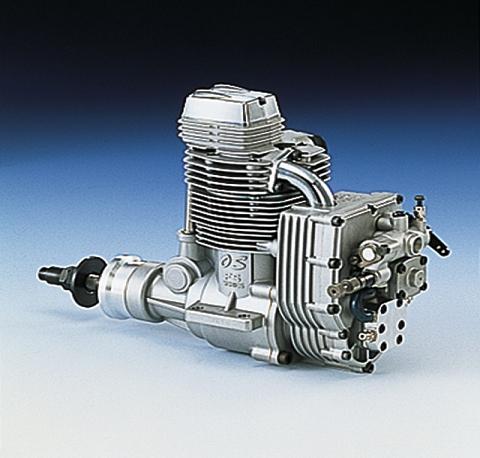

Here's a pic of the O.S. 1.20 Supercharged....

AMAZING!
I've never seen such a small supercharger before!! HAHA this is totally cool!!
Thanks for the pics!
IF this thing had a turbo.. what would it be? a T.05? spinning at like 120k rpm? lol

That OS indeed uses a real supercharger, however, it is so heavy that the extra power generated is largely neutralized by the weight...
But still, it is a fine piece of machinery.
