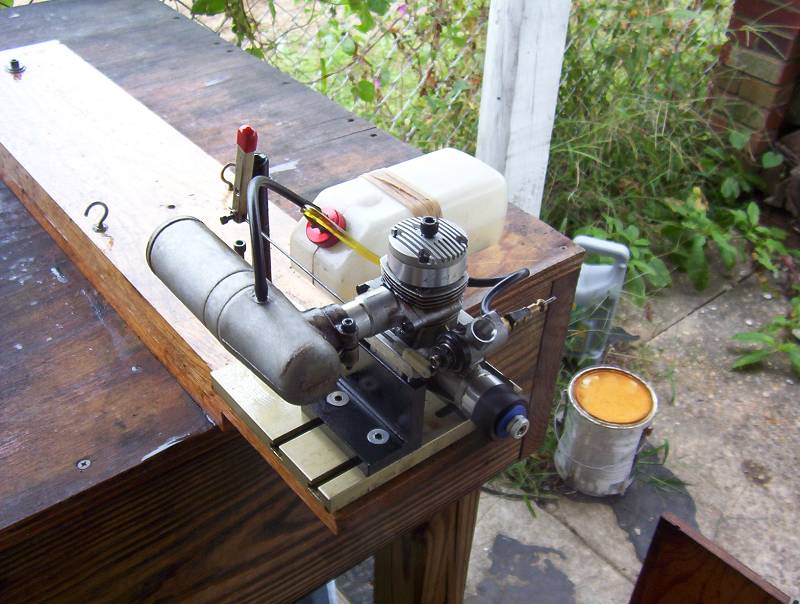

Buz, here is my SuperTigre .51 turning a 12x6 3 blade at 10,100 rpm. Note head and fuel lines.

How well does the 51 run on diesel. I have always thought about diesel as being a lot of trouble but others tell me that it isn't. I also wonder about the effect of the extra compression on piston, ring, rod, and crank/bearings. Understand that I have never seen a diesel glow engine run.

There is no extra compression, the fuel has ether in it to reduce the required compression, that .51 has been a Diesel since 1992, some glow engines have too much compression for Diesel operation, a High Compression Saito .80 for example. A Diesel will run nearly twice as long on a tank of fuel. With a Diesel you throw HP figures out the window and just watch it fly your plane better than you thought possible.
