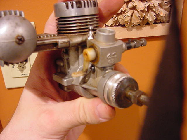

I lost the carb linkage arm this plastic horn seems to fit tight
will it take some heat cant find anything else. anyone have any tricks here until I can get one somewhere. in a pinch

If you can put a screw in that, you're golden. That looks fine to me. The screw will hold it tight.

Yes, I've replaced broken/missing throttle arms on a couple of engines with leftover servo output arms. They are made of the same material and work like a charm.
