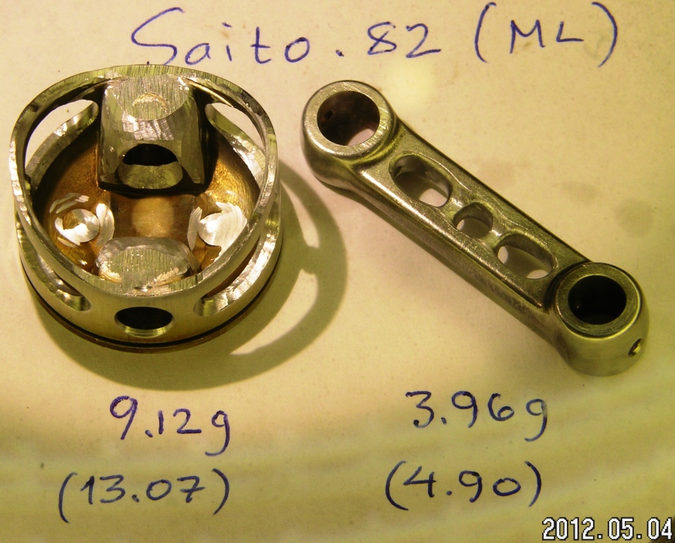

The modified .82 engine with a head space of 1.05mL giving CR=13.8 and a squish band of 0.65mm has now been run in benchtest and showed a marked improvement in power as compared to the results on the stock engine(9,500/2,700 rpm) in post #65 above.
Both modified engines .72GK and .82 were run with the same 13x8 prop. and the .82 has now "overtaken" the .72GK so the performance order is now restored:
.72 GK gave 9,500/2,400 - sweet running..
.82 engine gave 9,800/2,200 - harsh running..[]..some detonation..??
Using the .72GK as reference the modifications on the .82 has gained some 400+400rpm=800rpm gain. Why the .72 has "lost" some 400rpm since post #65 is probably a combination of warmer wheather and less nitro in fuel (5%) and both engines now have velocity stacks fitted.

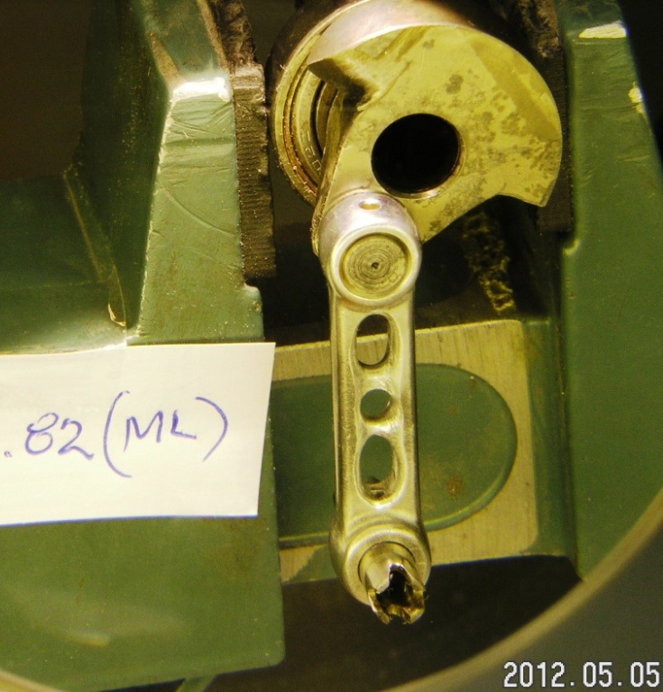

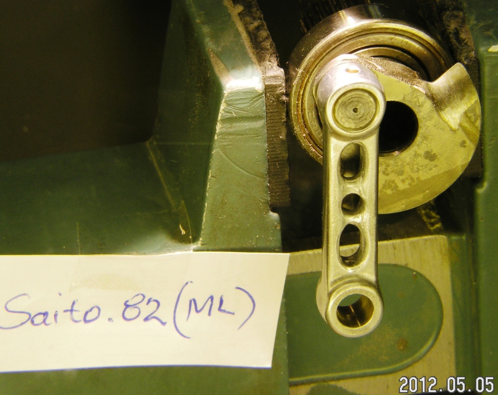

However, I am not at all happy with the .82 due to harsh running and vibrations so I took it apart and put the piston back in the lathe and shaved off another 0.15mm from the crown.This increased head space to 1.10mL with corresponding CR=13.2.
As you see from the "balance act" pics the .82 is still markedly "under-balanced", the crank counterweight can only balance out the lightened conrod but not the wristpin, piston, ring and scuff pads. Further lightening of piston and conrod done - see pic. but this skeleton .82 piston is still heavier than a stock .72 piston...[:@]...More later after new bench test..

OK folks I am at the "end of the road" regarding the .82 engine. Still got 9,800/2,000 in bench test and still with rather rough running. The tick-over is nice though, had it going for some time at 1,600-1,800 but 2,000 is stable. All on 5% nitro, 5% castor, 10% ML70 oil-balance MeOH, brand new OS F plug and 13x8 prop.and large plastic spinner.
Ran the .72GK at the same time under identical conditions - even the prop nut/washer was the same.....and it gave 9,400/2,100 with much less vibrations.......sweet..!
That´s it for now from my "tinker shop"....the .82 now goes into the Kelly F1 Racer and the .72 into my Ultra Sport.60.....sack time..
