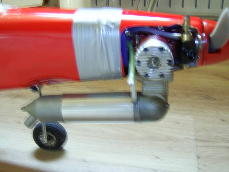

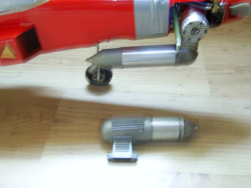

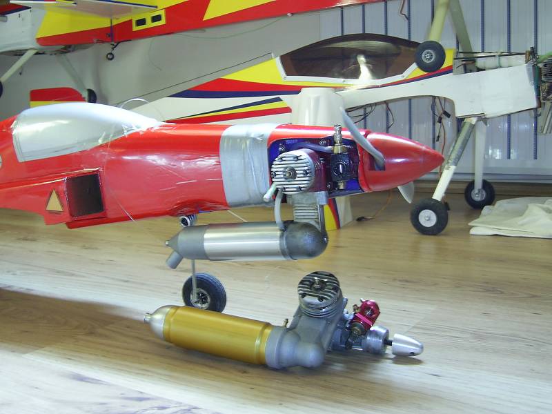

Well, I did it, Those parts are interchangeable and the end part of an .91FX muffler fits like a glove to a .46 Tower Muff. Now I have to find fine weather to try. Ankara is windy today and We are expecting some snow for tomorrow.
My Irvine .53 with Tower muffler will turn a 10 x 7 (cut down to 9x7) prop about 15.5K with %5 nitro. We will see what it can do with a T.O.S. Muffler. I like to see something around 16-16.5 K. which will be closer to Jett. ( My second hand Jett does 17,5 with the same prop with %10 nitro. But I am having some problems with the idle.)
As you can see from the pictures * sorry about the poor focus * the new muffler is about the size of a Jett .60LX muffler. I wonder if it is as good....
. With the rest of the two I can still make a short muffler..[
I will post the result.
Regards.
Zafer Turkeli

Today I had the chance to try my new muffler. Same 10x7 (cut down to 9x7) prop, % 10 nitro, 0 deg. Celcius. Irvine was turning 15.800 rpm on the ground. I guess it is not worth trying. Besides engine was turning 15,5K with original tower muffler with %5 nitro. So I believe It will turn 15.800 with Tower muffler with %10 nitro anyway.
Another point I would like to state that, It takes much more time to get it to the max rpm. And the plane was a little bit faster in a dive. The sound was way louder.[>:]
I think the speed was around 100-105 mph.
So If I have to answer my own question (What If.....) I should say.... NOTHING REALLY. [&:]
I have already put the original tower muffler back on.
Have fun.
Regards.
Zafer Turkeli
