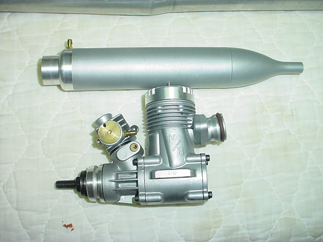

can someone tell me more about this engine?... is that a pump on the back?.. and what rpm might this be rated too?

That's a Perry pump on the back.
A guy at the flying field had one of those on a a Lanier Predator. That was the screamingist 40 size I ever heard.
He'd fly around for a while and every time he would throttle back a little, it would quit.
The Predator had a good glide angle and he always made it back to the field.
He had a tuned pipe on his. I think it was originally in a boat?

It was intended for DF use. Yes that's a pump. It was designed to run upwards of 20K RPM. Not exactly sure how high in the 20's. K&B called it a 7.5, for its 7.5cc displacement. Doesn't it say 7.5 on the right side?
I have one that the late Bill Wisniewsky, who was still working at K&B, modified for me. I was going to use it in a 40-size SWRA warbird racer. I ran into Bill at the Nats, asked him about the engine and told him what I planned to do with it. He said it had a 2-piece crank and that it would eventually break. He said the trick setup was to install a 1-piece boat crank in it, lose the pump and use a 60-size nitro pipe w/muffler pressure; prop it for 18K on the ground.
I wound up sending it to him and he made the changes, sent it back to me. It looks kind of funny because the front housing is rotated 90 degrees CW to accommodate the intake timing of the boat crank. I forgot all about it until I saw your post.
CR
Edited for spelling and typos (grin), CR

HaveBlue....do you have the pipe for it ? I have one almost like yours, it is a pylon racer,
but they are obsolete compared to the Nelson's and the Jett's and such....but it should be
one honkin' little screamer in a sport pylon plane.
FBD.

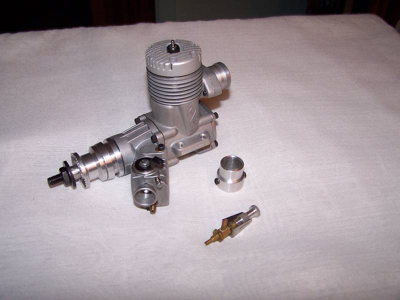

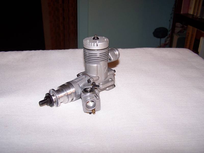

I tried to upload some pics of my modified 7.5, hope they came thru OK. Grrr...
I got a duplicate and missed one. I'll try again.
CR

I should have known. Your carb is missing the lo-spd adjusting screw. See the pic for ref. Are you sure that isn't the DF pipe? NOt arguing but it's awfully short.
CR

Guys,
I sent one pic twice in the previous post, sorry. The pic with the parts around it shows what Bill Wisniewski sent back to me so that I could use the engine in small warbird racer. Note the remote HS needle.
CR

From: Sydney, AUSTRALIA
Default RE: K&B 45 pylon or DF?
ORIGINAL: DarZeelon
The K&B 7.5 can be easily converted to sub 22K use, by simply dropping the sleeve and raising the head accordingly, to decrease the exhaust timing to about 160-165ΒΊ.
It will still respond well to a (longer) tuned exhaust. The mini-pipe in FBD's post will also be usable.
well that then defeats the purpose of getting this engine in the first place..
Old 02-05-2007 | 03:55 AM
DarZeelon's Avatar
Joined: Apr 2003
Posts: 8,913
Received 6 Likes on 6 Posts
From: Rosh-HaAyin, ISRAEL
ORIGINAL: HaveBlue
ORIGINAL: DarZeelon
HaveBlue,
Unless you actually want to have this engine spinning at 22K RPM, or more, the standard timing of this engine is way more than what you want.
For 18-20K you want 160-165ΒΊ and this engine has significantly more.
It is over-propped spinning 18K, probably to below its torque peak RPM.
This may lead to a lean-run, when this engine unloads significantly in high-speed flight.
Any engine propped below its torque peak will unload very significantly. If peak torque is achieved, or surpassed, as it unloads, it could reach ~23K RPM, which will require the high-speed mixture to be set much richer than you normally would, with a normal high performance engine.
