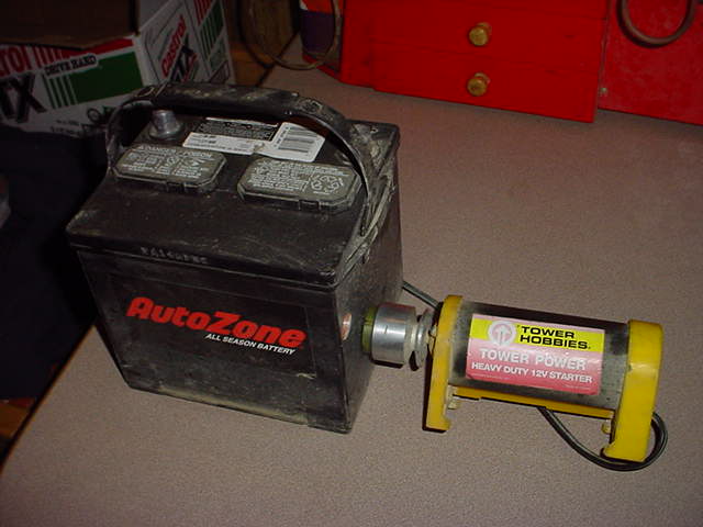

It's all in the battery....forget those little LHS gel-cell
batteries. Go down to the Auto Zone, or whatever....
and invest about $30. in a garden tractor battery. A
wet cell.....mucho gusto....you will notice about a 50%
increase in the power of your starter motor, and you and
your buddies can run field chargers, and the like all day
without fazing it.
Get one with the plastic handle on it. This rig will crank
3000, and 4500 S.T.'s....cold....

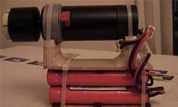

If you want a small compact starter that turns 120 4-stroke, go with Kavan starter with 14.4 volt.
I suggest to replace the cone with blue one (MIller starter cone)
I've been using regular hi-torq starter with 12V pack, but was too heavy to carry around. All my engines starts with one touch with starter, so I decided to use Kavan with 7x 7.2V car packs. The battery last pretty long and never had problem.
Here is the picture of my starter.
