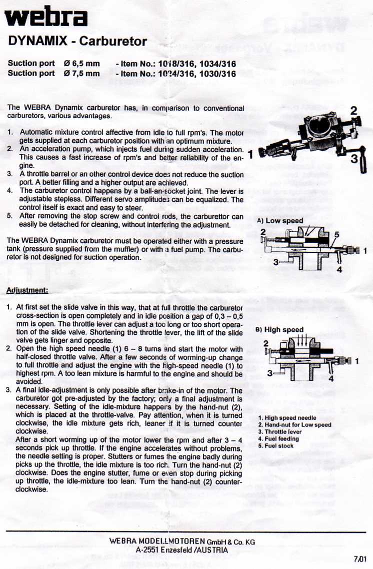

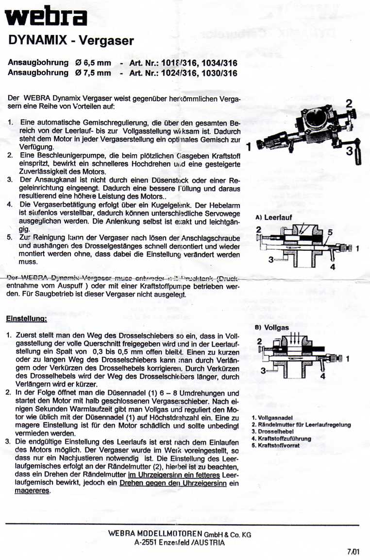

I thought I would start a thread on Webra Documents. This is the set that I have. First one is all Dynamix, Second set is All Engines and Carbs, the Third is Safety Instructions. Throw what you have in also if its not already shown!
I hope it helps those that are missing paperwork when buying used ones.
