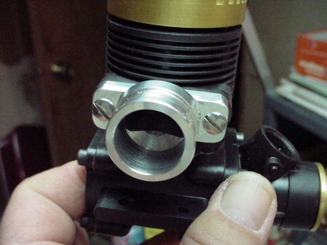

I picked up a older Webra .61 and it needs a muffler, It has no mounting bolts but that's a non-issue, I'm a machinist with all this nice machinery to make a strap on adapter to bolt up any muffler I would like, but need to know what muffler to make it bolt up to. What would be a good muffler. I was thinking the muffler from a Tower .75 might be good http://www2.towerhobbies.com/cgi-bin...?&I=LXVH43&P=7 but not sure if it would be a good choice for this engine. Let me know your feedback.

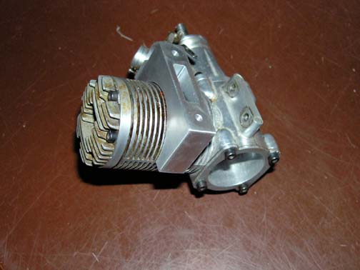

Old 04-13-2007 | 01:45 AM
Joined: Jun 2002
Posts: 1,227
Received 8 Likes on 7 Posts
From: New Bedford, MA
Default RE: Webra .61 muffler question
Well it's not pretty but it should do the job, The only thing is I will have to drill out the threads on the muffler and thread them into the mounting piece. only thing left is to get a strap to go around the engine, didn't have much time to do this but I managed to get 2 made (proptop) If I had more time I would have made it look a little better but if it works, Then I'll be happy. I also put the threaded holes at 41mm so it will fit the Tower muffler from the .75. Monday I should have them finished up and if I have time will make them a little more narrow and clean them up. I'll need your adress when I get them finished proptop.
Dauntae

Dauntae,
The newer Webra .61 has the muffler bolt holes drilled and tapped in the exhaust stack, at an identical configuration to MVVS .61-.91 and to OS.61FSR (and their clones).
Due to cost and quality issues, as well as being able to select between five (5) different muffler options, a significant number of OS.61FSR and Webra .61 Speed engine owners selected to get an MVVS muffler/tuned silencer/pipe from me.
The older engines, like your own, have no bolt-holes, so the 'change nothing' option is to get some kind of strap-on muffler, or header...
But if you are, or you know a reasonable machinist, the 4 mm bolt holes must be drilled and tapped 34 mm apart (center-to-center - use a bottoming tap and don't drill as deep as the cylinder sleeve...), for the standard MVVS exhaust (or that from the OEM) to fit unaltered. If you use Imperial fasteners(4-40, 6-32...), you can tap the holes any reasonable size.
E-mail me if you're interested.

Hello again Dar, This particular engine cost me $25 and I don't really know how it will run just yet. I opted for the Tower hobbies muffler because it is only $18 but I really do appriciate the offer. What I'm really doing with this engine is planning to put it on a beat up Pica waco I got for $20 from a auction (rebuilding time) and piecing it all together for a older gentleman in my club that loves flying with my little group and we all have bipes(I have a 40 size Pitts, A Hog bipe and another Pica waco in great shape) so I am really having a little fun piecing this stuff together. The piece in the post above is something I made on my lunch break. If I put the time I could really go to town making this stuff but work has been busy and this particular gentleman would actually rather have it made cheaply than to have his friends spend money because he always feels guilty about accepting gifts. He just doesn't know what we are doing with this yet and will be surprised. He really is a nice old guy and lots of fun to fly with. Well worth the effort. Now I just have to figure out why this Waco came with 3 top wings and no bottom wing DOH (I wish I was joking LOL) Just curious though, How much would the MVVS muffler be just for an option?
Thanks again Dar

Dauntae,
I cannot write any prices in the open forum. E-mail me for specifics.
Let me just say that the normal MVVS .61-.91 muffler is cheaper than the $19 Tower unit; and has the advantage of fitting this engine directly, providing you make the threaded holes in the exhaust stack.
The Tower .61-.75 muffler will not fit and cannot be bolted onto this engine, as the bolt holes are 41 mm apart...
They will be too far apart, to allow safe drilling-tapping in the exhaust stack.
A much better choice would a strap-on muffler, but all of those are much more expensive still.

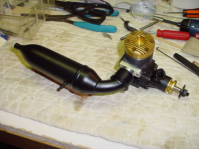

I have an HP Gold Cup .61 I plan on drilling and tapping the muffler mount holes, if I ever get a round tuit. I have a black muffler to fit I bought from Meccoa, however I am a little dissapointed it is just a simple expansion muffler and the black finish is flatter than the engine finish. I know that the HP and Webra has the same drilling as the old bolt on SF and FSR mufflers, but was not aware that the Rossi was the same size, or did you drill it for the Rossi?

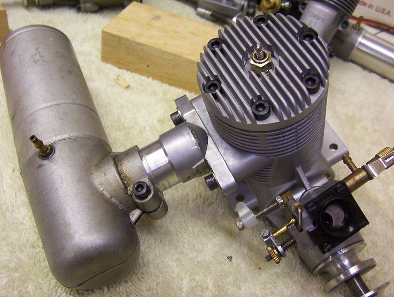

Old 04-13-2007 | 10:52 AM
Hobbsy's Avatar
My Feedback: (102)
Posts: 20,370
Received 30 Likes on 28 Posts
From: Colonial Beach, VA
This is how I did mine, even though this is a .91 I did the .61f exactly the same way.

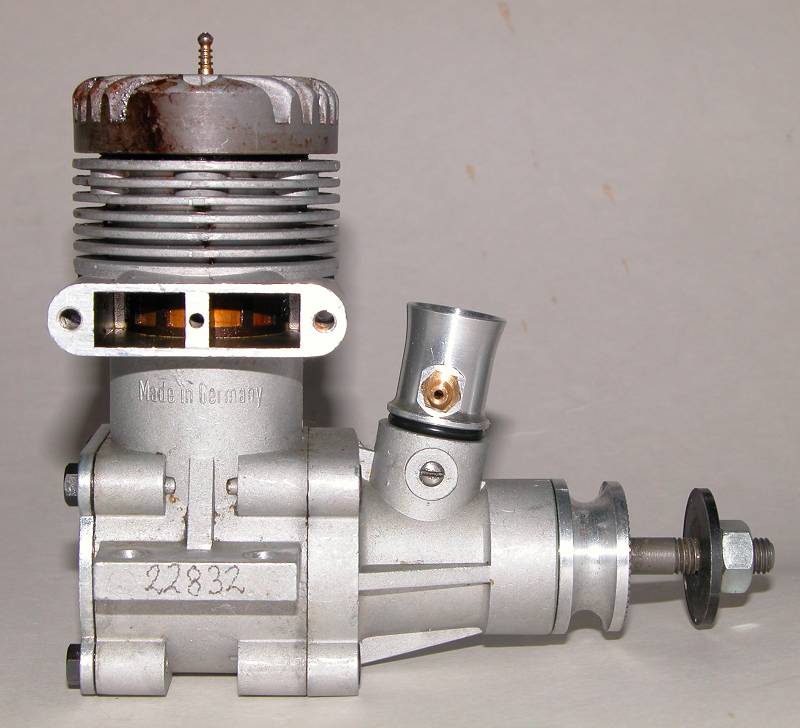

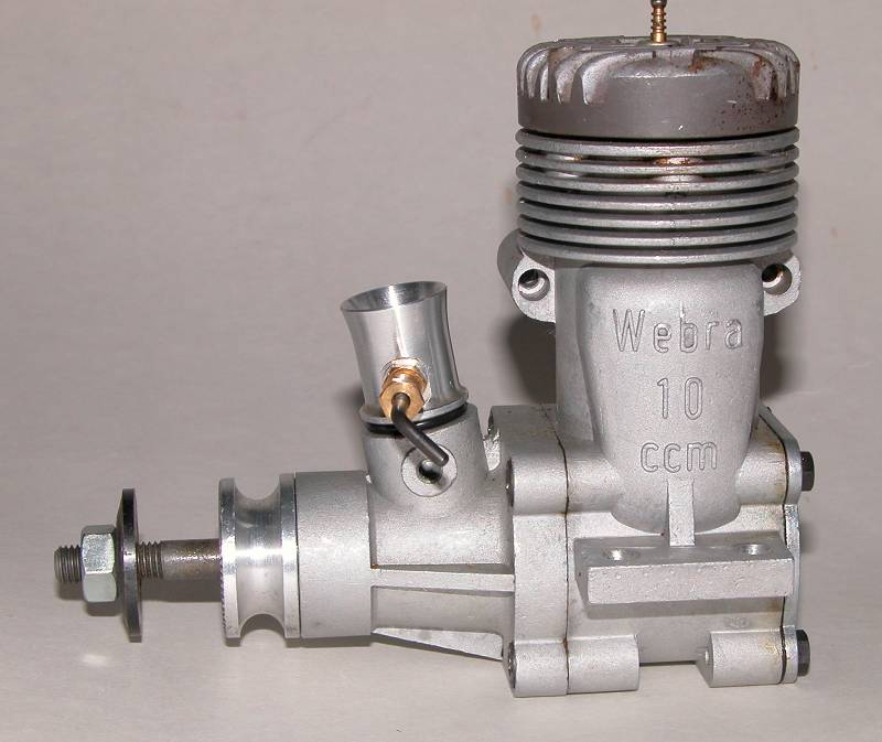

Old 04-13-2007 | 11:33 AM
Joined: Jul 2003
Posts: 1,282
From: Longwood, FL
I have one of those old Webra .61 Blackhead engines and mine is missing the muffler too. I've wanted to start this thing up for some time but the neighbors would probably get a little upset at the sound of a .60 size engine with open exhaust.
My Webra has been modified with a standard C/L venturi.
Back in 1969 the Webra was the engine to have in RC pattern events. A very good-looking design.
One of these days I hope to add a Supertigre Bluehead .60 and an OS .60 Goldhead to my .60 shelf.

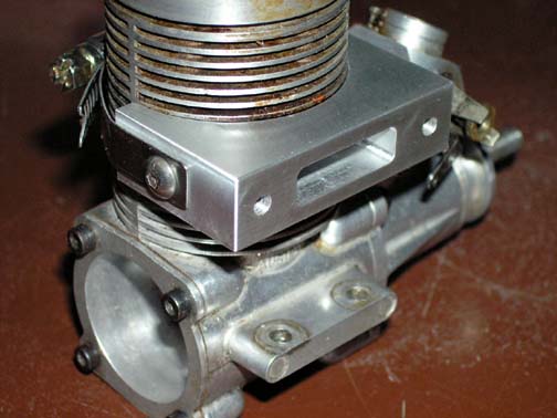

Old 04-18-2007 | 01:34 AM
Joined: Jun 2002
Posts: 1,227
Well I finally got a chance to finish them up (proptop I sent you a PM) took a couple of hose clamps to strap it on the engine and It's all set to go. I still have not decided what to do on the muffler but I think I may end up getting one from you DarZeelon but it will be in a few weeks. There are other things taking up my time as of late so this preoject will be on the back burner for a little while.
Dauntae
