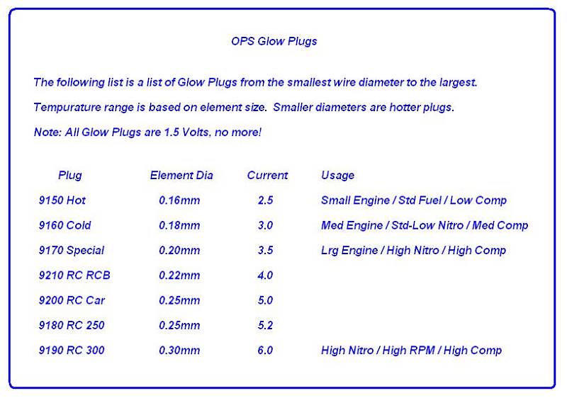

Here is a reference table of mine, I thought I would share and might be of some help.

Thanks Jetpack. The list is useful, however, I am not familiar with the plug discriptions. Were would the OS F plug be on this list?

I don't believe there is any type of cross-reference between manufacture's in existence. What I think might be helpful is the wire diameters vs. amperage. This does not take in account the number of turns on a coil which is unknown however, but it does give a slight picture of what goes on with wire size and amperage between one manufacturer's plugs.
