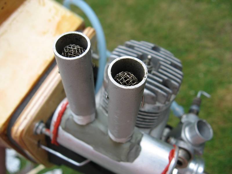

I've run into similar problems with the Slimline brand as well as the ones I've made myself. What I like to do is get some door screen material (the metal kind-stainless preferably) and mold a few layers (2-3) around the tip of my finger. Repeat process again molding the screen small enough to snugly fit into the exhaust tubes. I then take a pin drill (1/32" should be ok) and drill a hole clean through the exhaust tubes about 3/4" from the exit openings. Insert the molded screen "cups" into the exhaust tubes and pin into place with a pin from the wife's sewing kit. Push the pin through, bend over the excess, snip off point. Done.
This will increase the back pressure just enough and take the crackle out of the exhaust sound.
I'll try to get some pics posted.
I pulled out my Spit when I got home. Here are some pics showing a nice neat way to do it. This muffler works great!
I suppose you could 'cap' the outside of the tubes with the screen but that might look a bit hokey.

Hi Jazzy,
That is the neatest idea I have seen for increasing back pressure with the Slimline pitts
I'm hoping not to have to do it on my extra 300 (Goldberg BIY), the difference there is that I have the long extensions (9") on mine which will tend to increase back pressure. I've run about 6 tanks through the G91 ST and it seems fine, but now I know how I will increase the back pressur if needed.
Pete
.I'm hoping not to have to do it on my extra 300 (Goldberg BIY), the difference there is that I have the long extensions (9") on mine which will tend to increase back pressure. I've run about 6 tanks through the G91 ST and it seems fine, but now I know how I will increase the back pressur if needed.
Pete
Thanks Pete!
I've used SS scrubbers from the hardware store too. These look like crumpled up balls of tight steel coils.
I like this idea because the expansion chamber volume is extended to the screens (first point of any real resistance) which are near the outlet of the exhaust tubes.
I have the Slimline pitts muff. for an OS 1.08 on a Magnum 1.08. (I had to make an adapter/mounting plate.) The expansion chamber is decent sized but there is a noticeable back pressure problem there too. I put 3 to 3 1/2" neoprene extensions on the exhaust tubes but they don't do anything for back pressure. The neoprene does however help soften the sound of the 1.08 by dampening some of the vibration and 'ringing' in the muff.
