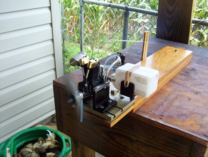

TJ, I got to try one prop a few minutes ago. On gut instinct I tried a MasterAirscrew 12x8 three blade, I did not any more than start the engine when my neighbors came out and began preparations for a swim party. I had three other props laid out to run, a MA 11x8-3b, a Graupner 12x8-3b and a MA 12x6-3b. I cut it short and just did the MA 12x8, I'll do the others tomorrow when I get back from flying.
Saito .82 GK
Prop==MasterAirscrew 12x8 (3) blade.
Fuel====WildCat 15%/18% 80/20 syn/castor blend
Plug====GloDevil 4C Special OS-f equiv. (Thats what it says on the package)
RPM====9,475, idle 1,825
That old saw about 3 bladers being ineffecient went out the window with Fred Flintstone. Here is picture of the .82 turning an APC 14x6, nearly identical rpm.

Hobbsy, you should have joinedthe swim party!! The 12X8 looks pretty good. Would like to see what you get on the other two.Tom
