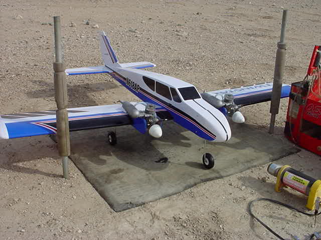

I'm running a hand-me-down OS .40 FP (about 15 years old but with low hours) on my Tower 40 trainer swinging a 10 x 6 Master glass prop on 15% Cool fuel. The old .40 runs like a champ and starts every time but just doesn't seem to pull that well at full throttle. Take offs are a bit slow and touch and go climbs leave me wanting more out of the engine. Should I try a different prop or replace the engine? I've got my eye on a Magnum .46 as an alternate.

.....I got a little surprise today, I did some Master Airscrew testing on a run of the mill
Magnum .40 in the Twin Star of mine. I hadn't run the engines for about a year and a half
and the fuel is opened 2004 vintage, but what the hay....
10-6....13,500
10-7....12,700
10-8....11,850
(get this)
10-9....11,100
Yes, Boys and Girls....you can use a 10-8 MAS prop on a .40 size engine.
