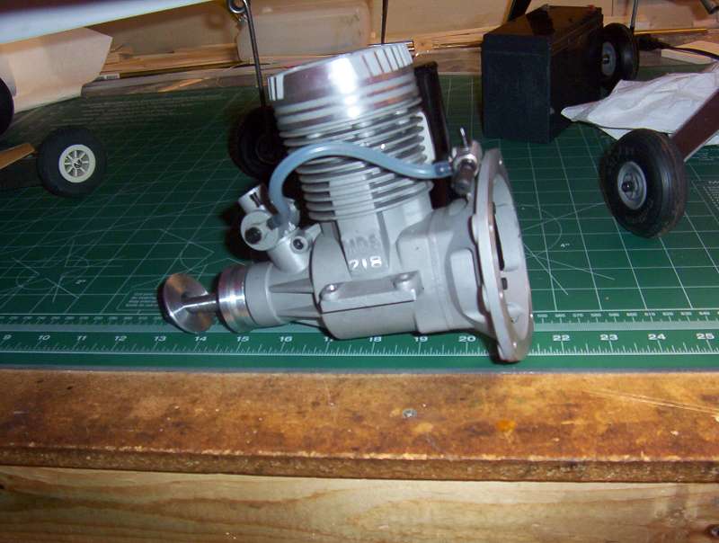

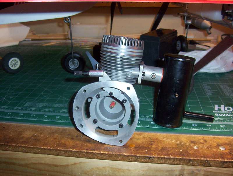

I have been posting to the forum questions about sources for parts for my MDS 2.18 engine. Two Member reply posts stated that, Quote "anything that fits the MOKI 2.10 will fit the MDS 2.18" and "...the MOKI 2.10 backplate that is a direct bolt on (to the MDS 2.18)"
Well sorry but thats not the case. Following those instructions I orderd a MOKI 2.10 backplate engine mount from JUST ENGINES in England. Well the part came today and, guess what? NOPE. Won't fit. It's like trying to mount a Ford transmission bellhousing on a Chrysler engine. They just don't go together.
So I guess I have a homeless Moki Radial engine Mount. Anyone know where to find a 'REAL' MDS Radial engine mount for my 2.10?

Apparently the motor mount on the MDS 218 in the first post is a real MDS 218 mount.
The Moki mount looks completely different and is a combination mount-backplate.

Yes,
the photo you posted is the MOKI 2.10 backplate radial firewall mount. That is the item I have just taken delivery on from JUST ENGINES in England. It was not cheap. $42.20 plus $14.70 international shipping []. Well, maybe someday I'll find a modeler who needs it...
