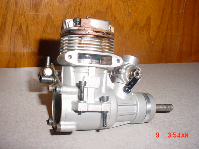

I have been having problems with two 2 year old OS 46 AX engines. The first one will run until I give it three to four clicks up on throttle. Then it completely quits on me. The second one was in the air when I slowly began to lose power. I was at full throttle and I was only getting about a 1/4 of the power. I have changed glow plugs, tried setting the needle valve thinking it may be running rich or lean, and even tried different fuel. Nothing seems to make a difference. I have posted pictures of the engine that was flying at the time of losing power. Has anyone seen this and/or are there any ideas as to what may be causing my problems?

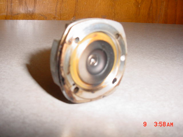

This engine clearly seems to have a leak between the head and the sleeve...
It could be that the head, or the sleeve, is warped, or that the head shim is trashed.
Were the head bolts all tight before you removed them?
Try to evenly and gradually re-tighten them and to try starting the engine again.
Before you start it, open the main needle and the low-speed needle significantly from where they are now.
By blowing air through a piece of fuel-line connected to the carburettors nipple, also check if the the flow increases as the throttle is opened further (fuel metering) and at full-throttle, as the main needle is opened further.
The burnt-on castor suggests it has been running hot.

The headbolts were snug, I didn't have to wrench very hard to remove them. Should I clean all the black off first before putting it back together? I will post pictures of the other engine also. Thanks

I suggest you clean the parts well before reassembly.
It has been said warm anti-freeze over-night will remove the castor gunk pretty well.

Looks like it may have had a life of running lean as well. DarZeelon is right, there's definitely a leak there.
Double check the fuel tank setup on the other engine. Very often an engine problem is actually a fuel tank problem.

You can clean with 0000 steel wool, or mothers metal polish, each will work fine.
I would check the rear bearing on each motor, O.S. has used several different bearings, and some of them don't hold up very well.

Dar is right on.
When you tighten up those head bolts, do one then the one on the opposite side. Criss cross the tightening process to prevent head warpage. Snug is not good enough but do not over do it either. They have to be tight. While you are at it, check the bolts on the back plate too. They need to be just as tight. When aluminum heats up, it expands. You want it to expand evenly as possible.
After your first run, retighten up all the bolts again paying attention to criss cross step by step tightening process. Check the back plate too.
The discoloration out side the engine is cosmetic. You can also try Dawns "Power Dissolver." You can get that at the Super Market, Wal-Mart, etc.. Follow the directions on the container, use an old tooth brush or something similar to scrub with. That too will help clean up the outer surface, but like said, it is cosmetic and has nothing to do with performance except to indicate you had a leak from the head.
