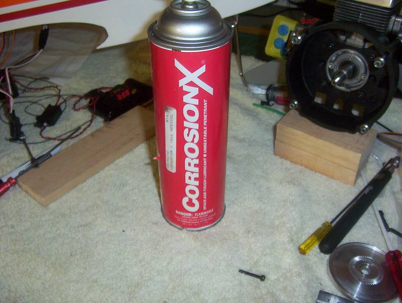

This will free it up in about 5 minutes and prevent it from happening again
