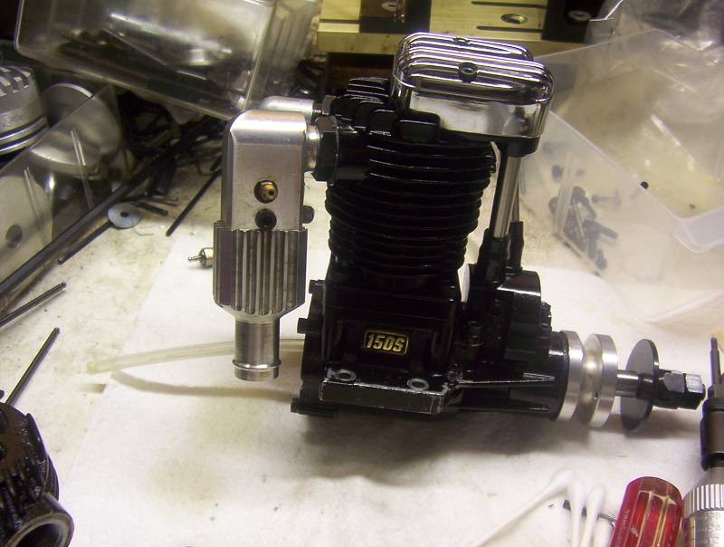

Here is an early high compression 1.50 with the chrome rocker covers. My daughter bought this one for me for Christmas in 1990 or 91. This guy can put a chicken stick over in your neighbors yard in a heart beat. I love it though.
