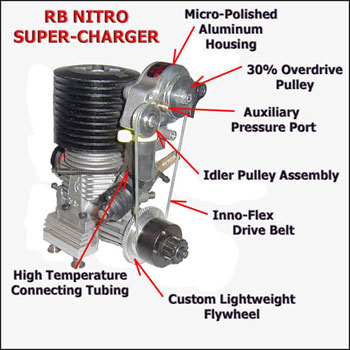

I just want to tell me what is with that "auxiliary pressure port in the picture".

....that "pressure port" is used to pressurize the fuel. When you supercharge an engine
you drastically increase the air flow into the engine. In order to get enough fuel into the
engine to get the proper fuel/air ratio when it is being supercharged (with air) you must
have a way to increase the fuel flow to match. This method works in a manner in which....
...as the boost is applied to the engine, the same ampount of boost (pressure) is applied
to the fuel (pressure). As the RPM (and boost) is increased, the pressure to the fuel is
increase the same amount. This is a way to get around the added complication (and expense)
of having fuel injection added to the engines as well.
FBD.

As with the rest of the "supercharger" this is purely an advertising gimmick designed to suck money out of impressionable newbies. This thing straight out doesn't work. Read the car engine forum here in RCU and you'll find pages and pages about this thing.
I am with downunder, i will say the "super charger" in 2 stroke model engine will not work.
Because the transferport and exhaustport are open ,and there are atmosferic pressure in the cylinder, hi pressured air/fuel mix are blowing out of exhaustport. The "supercharger" are not blowing the air/fuel pressure in the cylinder with pressure since the induction valve in crankshaft are allready closed.
You are throwing money out of window for the 2 stroke engine with "super charger" who are not more powerful than normal 2 stroke engine.
Better to run 2 stroke engine with tuned pipe.

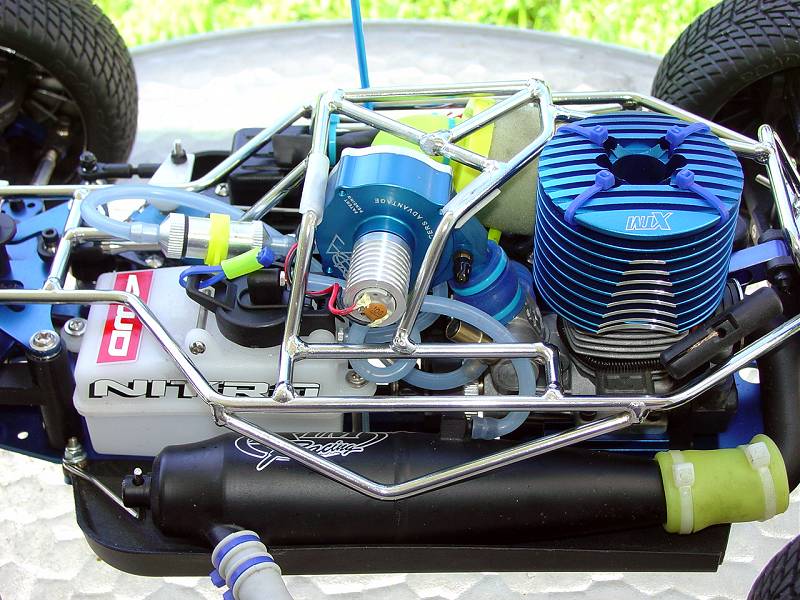

The OS FS120SP is a four stroke engine with a Roots type supercharger.
I have a 1/8 nitro buggy that I installed an electric supercharger on. I know, I know, I could have gotten a larger engine, more nitro, different tuned pipe, etc etc blah blah blah........ I do not wish to re-hash the merits or demerits of supercharging two stroke engines.
However, part of being a gearhead for me is playing around with, well, gears! So I installed this thing and FWIW, on 20% nitro fuel it required the HS needle to be opened a 1/2 turn richer than normal. It can probably be even richer, but I have not experimented with it any more yet. Without the supercharger, 1/2 turn richer on the needle caused the engine to bog down significantly.
Did it cause this 2-stroke engine to make more power? I dunno, I don't have an engine dyno. It had a lot more 'bark' to it and it certainly seemed to be making more rpm. In any case, it sure did have a positive placebo effect if anything!
And under other circumstances, more fuel being burned means more power.
Regardless, it looks cool, and it does not harm the performance in any way. So it is a fun thing to have and play around with.

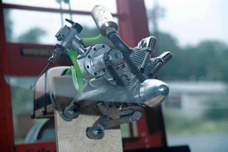

The classic supercharged model airplane engine of all time!

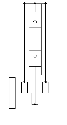

The opposed-piston two-stroke diesel engines for ships has turbocharger to example in Burmeister & Wain marine engine, but not for pressurized air in the cylinder as in turbocharged 4 stroke or cam operated exhaust valve 2 stroke engine. It improve shavening in the cylinder.

Jens, I was searching for a good link for an opposed piston engine and couldn't find one. They do the same kind of thing. Super or turbo chargers are not meant to pressurize the charge in these large diesels. They provide primary compression that takes place of the crankcase which is running in an oil bath.
Jens, have you ever looked at the Napier Deltic engines? What a piece of engieneering.
Click for fullsize
Kmot do you know who built this engine?
