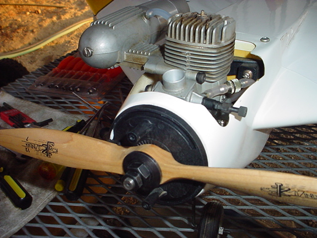

.....GP Big Stick....wood prop.....75 engine ?
Try this....[sm=thumbup.gif]
FBD.
