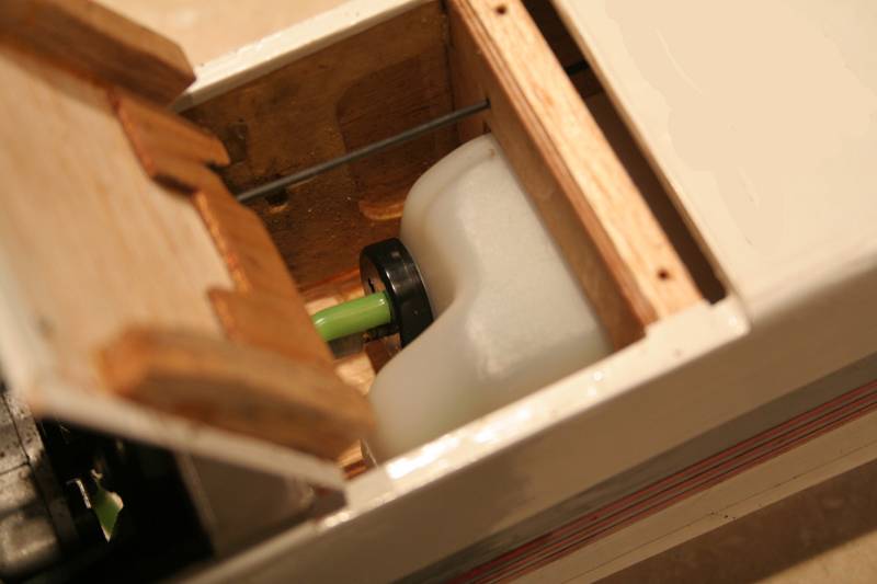

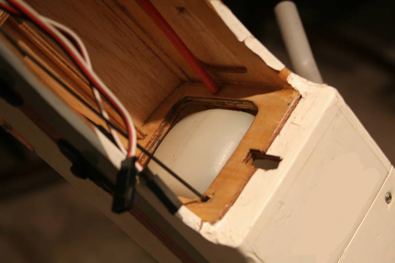

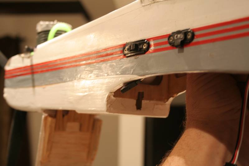

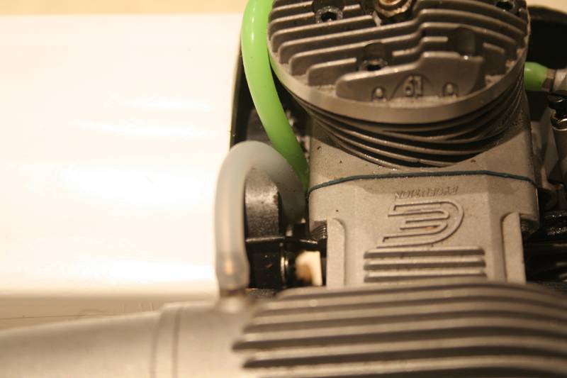

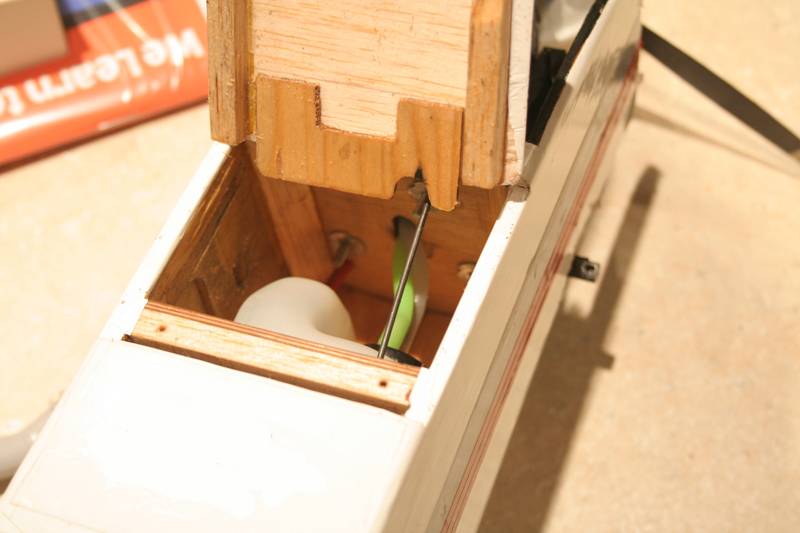

Here's the pictures as requested:
pic #2 shows the fuel lines running behind the engine and through the firewall. If I disconnect the lines from the engine they slide in and out through the firewall easily... So, they're not kinked or pinched in any way.
pic #4 is my feable attempt to show the relationship between the fuel tank and the engine. I think the stopper and lines are about 1/4" lower than the HS needle. That'd put the clunk about 3/4" below the HS needle.
pic #6 is the lines through the firewall. I cut that access door in the bottom of the fuselage. I braced it up so it would be just as strong before I removed the sheeting.
pic #7 is the rear of the tank in the fuselage
The fuel tank is mounted sideways (if there is such a thing) and the clunk moves freely to all four sides of the tank.

Thanks for the photos....
Before I say anything on the aircraft... engine trouble shooting rule #1
Remove the engine from the plane. Put it in on a decent test stand.
(you are an experienced modeler and may already practice this, but for the benfit of others reading...)
Controlled conditions - easy to see - easy to adjust - easy to make changes. Generally is more sold and stable than the airplane installation.
Run the engine. Keep it configured at first as it was in the plane. Same prop, spinner.
If it still misbahaves, check and change what is possible. Prop - plug - fuel. Change one thing at a time.
If it runs properly on the test stand, you have just isolated the problem - and the fault lies somewhere in the airframe/fuel system.
Something to consider based on seeing these, it was not clear entirely, but it looked like the tank is a fairly tight fit in there.
You should isolate the fuel tank from the airframe. Rubber padding all around.
Although you noted that you did not see bubbles in the fuel line while testing on the ground, it is not impossible that, in flight, the harmonics can cause the fuel to agitate and create foam in the tank. Once foam appears, the engine will go lean, and there is no two ways about it. Once those little temperature spikes hit the engine.... it is just not going to run right.
In my experience trouble shooting engine issues, over 90% of reported problems were traced back to the fuel system. So that is usually the first place I recommend that folks look. To this point, you have obviously followed that fault path per your photos and descriptions... as you have specifically check many elements in the fuel system.
That might not entirely be the problem, but it is good practice to isolate the fuel tank.
One thing I would do first --- remove the exhaust extension. See if that makes a difference. Sometimes, under the right conditions, the extension can act as an inadverting tuning device as it hits a certain frequency (rpm). This can cause surging. Yeah, its a long shot, but by far the easiest thing to try first.
Second easier thing to try, or at least worth an experiement.... change to a different prop. Unload the engine a bit and see if it happier. Two blade 11x7 would be a good start, then perhaps try a 2 bladed 12x6. A bit less load, and the engine will respond differently to each prop as it settles into an rpm range.
Let me leave it at that.... let me know how you make out.

One thing that has always bugged me though. The engine seems to dump a ton of raw fuel out of the exhaust even when it acts like it's running lean. It's happened on all the fuel types I've run though it (maybe except a full synthetic 15%, I'm not sure)

Maybe it's just the angles of the photos, but it looks like your fuel tank is mounted too low. The top-side of your tank appears almost level with the center of the carburetor inlet.
In a desired arrangement with the airplane sitting level, the center of the carburetor inlet would be ~1/4 inch above the centerline of the tank. With a 12 oz., side-mounted Dubro tank, the tank centerline would be ~1-1/4 inch below the top-side of the tank. The desired arrangement would have the top-side of the tank ~1 inch above the carburetor inlet .

There is some validity to keeping in mind the tank location. You do want the tank in decent proximity to the engine/carb/crankshaft.
But also consider, that the tank "location" only exists for straight-n-level flight. So the engine has to be tolerant of drawing fuel uphill, downhill, and under g-load conditions. Example would be, consider where your clunk location is when climbing out on takeoff at ... say .... 20 deg nose up. Most engines run fine like this.
On my own test stand, the the tank CL ends up mounting about 1/2" below the spraybar in the carb. At full fuel, the fuel level is above the carb, and obviously as fuel runs out, it has to go up hill a bit. At low fuel conditions, that results in about a 1.5" below-carb fuel level. I have not run across an engine that did not run through a full tank.
My point here, the tank position is something to consider, but its probably not causing the surging.
About the raw-fuel dump...
If its obviously spraying raw fuel in the exhaust, and still acting as if it is hot/lean or really sags off ---- it may be overly restricted on the exhaust.
