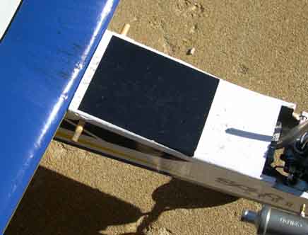

Hey Guys, I've got a Saito 62 four stroke turning a 12x6 prop and I'm using Magnum 15% with a synthetic/castor mix. I broke the engine in with this stuff and have been using it with no problems. The manual says not to turn more then 11,500 RPM so I've got it turning at 10,200 max RPM on the ground. The engine runs fine in the air and I haven't had any trouble but I did have to adjust the valves finally. Anyway, after some flights I've noticed a black oily residue on the front of the plane and wing. I can't tell if this is good or bad and the fuel coming out the blow by tube underneath looks fine with no color at all. While I'm flying most of the time I fly 3/4 throttle and the engine doesn't seem over heated at all. Is this black oily residue normal?

If you've verified it's not coming from the crankcase vent, that's very good. The black residue could be coming from a loose muffler, or some other loose part, check eveything for tightness. Dark grey or black goo is usually metal dust mixed with oil.
After looking at your pictures closely, that little bit may be nothing at all, Is your field dusty, fly off grass? The oil you see on the LE of the wing will be caused by fuel spitting from the carb and maybe some leaking past the front bearing, all normal stuff there..............

rcdude7, there was another thing I forgot to mention, when I had to adjust the valves on the engine one bank was clean as a whistle and the other one had the black oily mess all over the rocker arm and under the cover too. I'm guessing that bank is the exhaust valve side with the black oily mess.
Looking at the picture of the plane you can see that oily mess is right behind the engine going up to the L.E. , there isn't any coming from the muffler on to the wing that I can tell. So maybe it's coming from the engine somewhere and getting mixed with whatever but the underside of the plane is always soaked big time from blow by.

Brown is ok, black MAY be bad. Take a close look at it. If you see tiny silvery metallic flakes in it, the engine is MUCH too lean.

The black stuff can come from a lose silencer (aluminium rubbing against alu makes black residue).
Also try a larger prop like a 13x6 APC.
