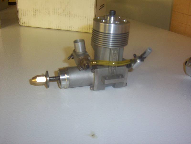

Ski, I ran a Cline on a MDS 1.48 converted to Diesel with a remote needle and I have remote needles on 4 OS LA's and this Fitzpatrick Diesel. It's a non issue.
