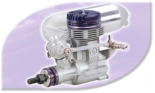

1. The seal between the carburettor's body and the crankcase... If the carburettor bottom and the crankcase are both quite smooth and the O-ring is flexible and not torn; and the carburettor is pressed down against the O-ring, there is absolutely no reason for anything but an air-tight seal in this location.
If the carburettor cannot be pressed down on the O-ring... See the Tower .75 photo... No Seal!
2. The carburettor pinch bolt/draw-bar... Is the fit of the bolt part in the crankcase so loose that a really bad leak exists in this location?
If so, after the carburettor is held down and the nut is tightened, wipe the area clean with some methanol and after it is dry, put a dab of RTV silicone on both the blind end and the nut. And you've got no leak there after it vulcanizes.
3. Between the carburettor's spigot and the crankcase... If (1) and (2) are sealing OK, this is of absolutely no importance...
No need to 'dunk' your carburettor in red RTV silicone...
4. Between the carburettor's barrel and body... That is the manufacturer's fault, but a dab of silicon vacuum grease on the barrel will solve this problem for ever, even if it does make the throttle servo work a little harder. Use a thinner grade.
Fuel will not wash it off.
5. Between the crankcase and the crankshaft... This is incorrectly thought by newbies (end some 'experts' too), to be a leak through the front bearing.
The front bearing is not supposed to seal the engine! Period.
It is the crankshaft's front rotor that must seal against the crankcase and also to function as the intake valve.
No seal there - there are no excuses.
If there is a leak there, these parts, or the whole engine, must be replaced by the manufacturer, because these parts that must seal are out of tolerance and are not sealing...
And no, a sealed front bearing would not fix that!
You've had more than your fair share of leaky engines, I believe...
