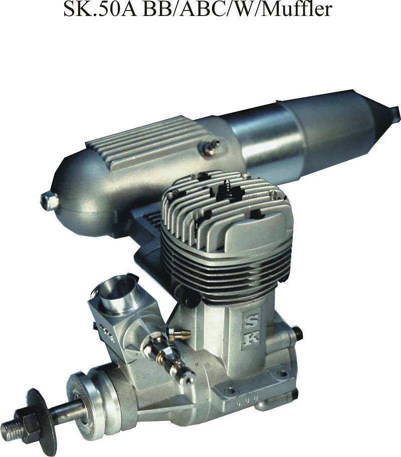

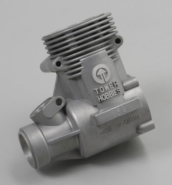

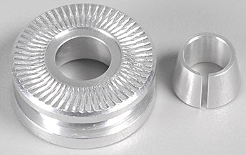

Default RE: JBA .56
Don't be so sure that the SK and GMS/Tower/Super Tiger engines are not made in the same factory.
Look at the mounting lugs of either of these engines. On the outer edges you will see the same numbering system. On the right lug is the year and month and on the left lug is the manufacturing sequence during that month. There is also a lot of similarity in the way the castings are designed around the bypass ports and the way the carburetor looks. The parts pictures are of a GMS 47
Tower 46 B&S 22 X 19.6mm
GMS 47 22.4 X 19,6
SK 46 22 X 19.6
SK 50 (I mean 52) 23.64 X 19.6
JBA 52 23.64 X 19.6
JBA 56 (oh I mean 58) 23.64 X 21.6
JBA 56AR 23.35 X 21.6

Default RE: JBA .56
Hi W8ye,Though SK crankcase has a manufacturing no (ie:KA 01569) at left lug,no signs on right lug.Crankcase carb base casting is square
not rounded and prop driver hub has no separate cone,only has a matching flat surface sliding onto crank.So Im not sure,same factory products with Towers.But carbs seem same factory production most likely.
