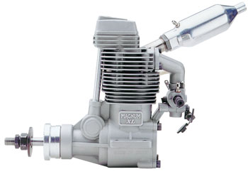

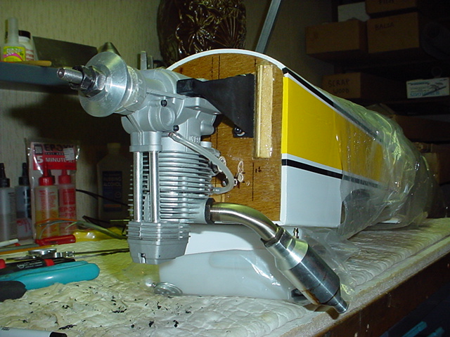

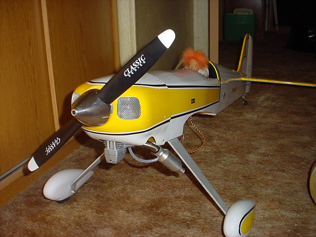

....Welcome to R/C Universe, justinkserv....[sm=thumbup.gif]For your first 4-stroke I would recommend the Magnum 1.20 for that plane. While it
may be the least expensive of all the popular 4-strokes....it is also the easiest to tune,
one of the most reliable, and all the parts are available. As a side note, the parts cost
a fraction of what the parts cost for those other engines, usually 1/3 to 1/2.
I use one in my big Dragon Lady. It is not a racer, but it is a sweetheart.
