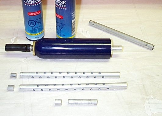

Martin Hepperle has some downloadable software for designing a silencer:
http://www.mh-aerotools.de/airfoils/software.htm
I don't think it'll rob too much power from it. Check it out.

I've made a whack of mousse can after mufflers which really quieten things down. I see on E-Bay there's always these silicone tuned pipe looking after mufflers for sale. They appear to be available in 3 different sizes, the smallest appearing to be ideal for small .15 to .25 size engines... from their looks I'd say they'd do a surprisingly good job of quieting things down. If you try 'em out report back how they work. I know the mousse can idea works very well - I've even built mufflers using smaller aluminum shaving cans, obviously intended for travellers. Check out the (hopefully) attached image to see how I do it... An aluminum plug is inserted half way dow the tube which forces the exhaust gases to travel through the holes in the centre tube. The gases expand in the can of course and the tube acts as baffling. The tube is epoxied to the can using JB Weld. If you use aluminum tubing and cans, the end result can be quite light, very quiet and have minimal impact on performance. I've used them as after mufflers (attached to the stock muffler) and as the primary muffler on a header. You can find aluminum cans like this in a variety of sizes suitable for a wide range of engines. I dare say I think they work better than anything you can buy.

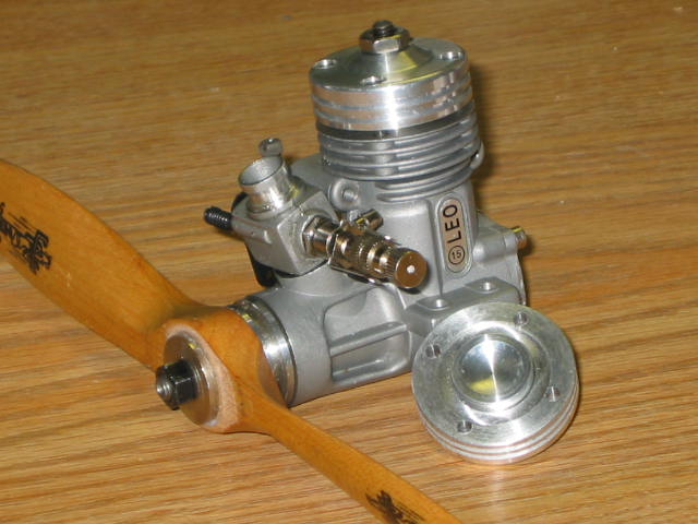

Have you considered going the diesel route? Quieter and if you route the exhaust to rear of the plane with plastic or aluminum tubing, it is quieter still and your plane will be much cleaner. Your .15 won't be much louder than an electric.
You won't lose any power - in fact you will gain with the ability to swing much larger props (even a 10in. prop is not unreasonable on .15 size diesel).

Is it possible with a diesel? Well you know how everyone loves to hold their brand new engine in their hand, put a little fuel in it and flick it over just to admire it? Try that with a diesel and you're likely to have a handfull of screaming monster
However, Murphy's Law states that when you put it on a test stand you won't be able to start it.........

I'm in the process of breaking in a PAW .19BR diesel for my Lazybee. I've never owed a nitro or diesel before.
Coming from electric the noise issue was very important for me. After a rough first attempt, getting it started has been fairly easy and the adjustments are far from complex.
I just hope that the .19 isn't way too much power for it!
Here's some great info on diesels http://www.carlsonengineimports.com/...eselinfo.shtml

Before reading any of this....
I built (if you can call it that
) a mouse can after muffler using, coincidentally, the exact same Mouse can pictured in post 9.
The can cost a wooping $1.33 (CDN no less). I used some cheap, hardware store, copper tubing. Total cost - less than $2.
I used Martin Hepplers software as well. My mousse can is setup as a simple exansion chamber, but I built a couple of others (other types of can's - but the mousse is nicest) setup as high frequency band stop filters to test as well.
The expansion chamber has very low attenuation at multiples of it's own resonant frequence. I tried to set it up so that these did not align with multiples of the engine's firing rate at max throttle.
I have a OS46FX with a Jett Stream muffler that generated about 100 dB at 9 feet, 90 dB at 20 ft. Not crazy, but a bit too loud for mixed company.
I'll get the mousse muffled dB measurements and let you know how it worked.
My long term solution is a Mac's quiet pipe. As a quick work around the mouse can is great. It may find a permanent home on another plane.
(It was quieter, when I tried it it, but it certainly didn't seem as quiet as I expected based on the reduction predicted by the software. Took away about 500 rpm.)
