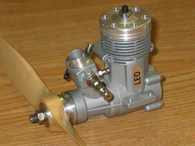

Have several of these engines and they are reliable, good runners. Not the greatest in power though but great value. See pic for a diesel conversion that I made for these engines.

What are the pros and cons of diesel conversion?

I also want to know the plus's for doing the conversion and where can you get the conversion to diesel kit from?

Advantages of diesels:
1. Ability to swing larger props (because the ignition timing can be adjusted by varying the compression ratio). You can run 13-15 inch props efficiently with the .46 engine.
2. Cooler and much quieter (sp?) running.
3. More power/torque (especially with larger props).
4. Lower fuel comsumption - the optimum fuel/air mixture ratio is higher (approx 15:1 for diesel vs 8:1 for glo) thereby allowing you to use a smaller fuel tank (about 50-60% of the size for glo). The fuel/air mixture is much leaner - that is why engines with smaller carb openings are not a problem.
5. No glo plugs or glo starter required - sorry forgot about this one.
Disadavantages:
1. Smell - because of the kerosene content of diesel fuel. Others, including myself are experimenting with Biodiesel as a substitute for kerosene, which is much better in this respect - in fact, depending on what the Biodiesel is made from it can smell like french fries.
2. Black mess - again Biodiesel is much better in this respect as it does not require as much lubricant due to its higher lubricity (so far it seems like less than 10% lube is necessary). Also, because diesels are much less sensitive to exhaust back-pressure, you can run a tube to the back of the airplane thereby keeping the mess almost completely off the airplane.
3. Limited availability of diesel fuel at LHS's.
I make these conversions for several engines now from .15 to .46 sizes. When (and if) the decision the is made to make them commercially available, they should run $20-$25 each.
If you are interested to try one of these on the Leo/Mecoa .46, let me know and I will send you one FREE to play with.

It doesn't look like there is a glow plug.
How do you start the Diesel?

Spaceman
Rmteo sent me this link http://www.carlsonengineimports.com/...eselinfo.shtml
This explains how a diesel works. I have just e-mailed him back and I am going to try one of the diesel conversions on my Mecoa 46.
I have a 1/6 scale Piper I would like to use a larger wood prop on to make it more scale like.

RmTeo 1 great looking head nice job you need to post a pix of this and a bit of info on the the diesel site regards martin
