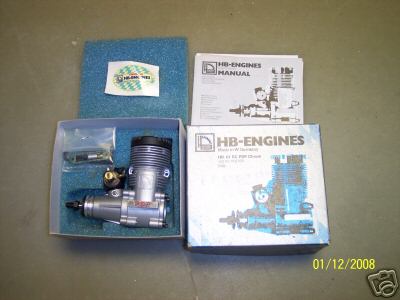

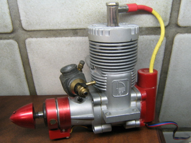

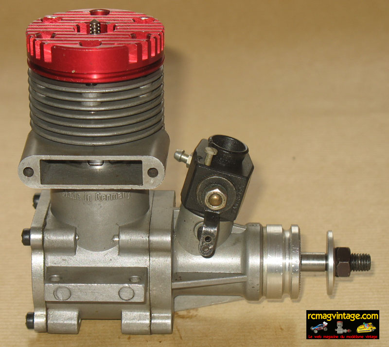

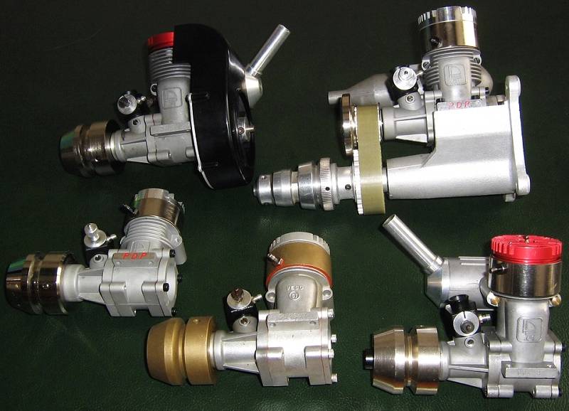

#42
My Feedback: (20)
They're excellent engines. I'm not sure what the new MECOA ones are like but the originals are truly "Flip and Fly" and they will "Haul the Mail".
Even if they are not the PDP version I would snag them. (if for no other reason than to give one to a kid just starting out with a trainer) They idle down great.
If they're black heads you hit a Home Run. They were made with pre-EPA hardened chrome cylinders. The regular PDP models use a dykes ring if I'm not mistaken.
The smaller engines were a Lapped Piston Cylinder and ran ok. The little one screw mufflers worked great.
The military used a single bearing Drone model that had a "fake" bearing to the prop drive. (cheaper)
If you've never owned one I highly recommend them, you'll get alot of "What the hell is that" at the field.....
