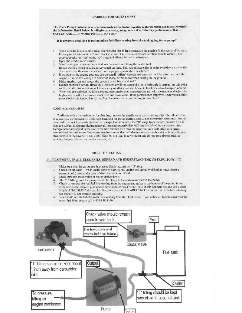

I just got the idea to try small diameter fuel tubing from the pump to the carb (OS 120AX):
My engineering school brain says it won't make much of a difference; the pump is working at a given rate based on engine speed and therefore provides a flow rate independent of tube size. The smaller diameter tube will mean that a smaller volume of fuel will go through the tube, but will flow at a higher velocity providing an equal volumetric flow rate compared with the larger tube. Unfortunately I don't know enough about how fuel is drawn through the carb and thus how it would respond to different loading conditions.
The other part of my brain says too much fuel to begin with, smaller fuel tube has got to change something.
It's pretty late and I feel like I'm missing something (like what might happen at WOT?) so any thoughts would be great. As of now the screw on the pump is out far enough that I'm worried about it falling out and my low speed needle is either fully closed or darn close to it. Performance is OK idle, decent transition, and decent top end. Not much room left for adjustment but I believe I should be able to achieve very good idle, transition, and top end.

I got a call from Gary at Connely (sp?) who sells the Perry pumps. He advised to use a 'T' fitting as close to the carb as possible, and run a third line as a return line. He said all my problems would be solved[8D] Makes sense, and this is even how our diesel test engine at school is setup, with a fuel pump and a return line from the fuel injectors.
I am probably going to try the narrower fuel line first, and maybe even on the pressure line. Easier fix than pulling the tank, but truthfully I don't think the thinner lines will do much.
Old 04-17-2009 | 03:41 PM
Jetdesign's Avatar
My Feedback: (8)
Joined: May 2008
Posts: 7,056
From: Honolulu, HI
Default RE: Perry Pump Questions
Today I tried everything, and got the pump working pretty flawlessly.
The narrower fuel line did nothing.
I set up a 'T' very close to the carb as I was told by Connely. I first tried it with a one-way valve in the line and this was not much of a help. There is no pressure running through the extra line, just fuel. I believe the fuel got to the valve and stopped.
Last I tried with regular fuel line from the 'T' to the tank, and found satisfaction. Very, very good transition, easy tunability, and much better fuel consumption. I tried this setup first with the extra line feeding into an external tank, and A LOT of extra fuel was coming out. The Perry pump really works harder than it needs to. All that extra fuel that was bogging down the transition was getting shoved out of the muffler, unburnt. With the extra line, all that extra fuel just goes back to the tank, and I got a few extra minutes of run time.

I found this online. Shows how using a T to relieves the pressure to the carb.
