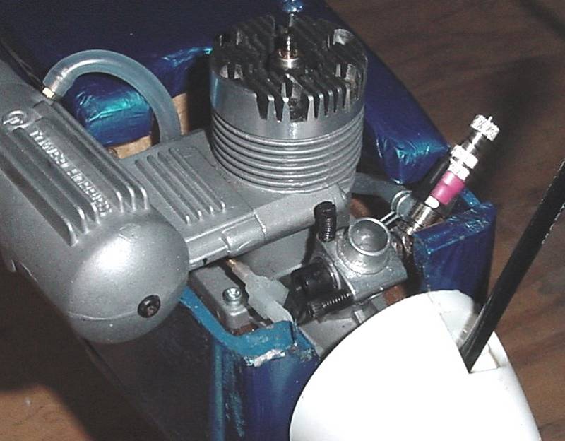

I am a returning R/C airplane hobbyist after a 30 year absence. My son gave me a new (old) Tower Hobbies .40 R/C ABC engine but no owners manual. He had it for years but never got going in the hobby. I called Tower Hobbies and they do not have a manual because this engine was discontinued. In days long gone our R/C engines had only one needle valve. This thing has three. One big one and two smaller ones. I want to break the engine in but I'm having trouble getting it to run continuously. Are there any basic setting for these needles like screw in all the way and back off X turns? If somebody has the manual would you please tell me the recommended setting? Also who (manufacturer) made this engine for Tower Hobbies? Maybe I can get the manual from them. Thanks.

Make the big one three turns to start with.
There were two different models of these cars. one had the big needle straight into the carb and the other had the needle at an angle to the rear
The one on top is just a throttle stop screw. Adjust it to where you can just close the throttle all the way
The one opposite the big one goes across a hole on the front of the carb. Make it go half way across the hole in the beginning.

Hi Aug...
Three? Hmmm...there should be a High speed, a Low speed, and the idle r.p.m. adjustment stop screw which is also the carb barrel retaining screw.
The Hi and Low are the only ones you really need to concentrate on, for now...
I would set the high speed at around 3.5 to maybe 4 turns out...
Setting the low speed can be tricky if you don't have a baseline setting. The low speed is the one that's in the center of the carb arm.
While looking down the barrel of the carb, adjust the low speed until the tip of the needle till it's about 1/32" away from the spray bar (or fuel inlet tube ) at Wide Open Throttle (WOT )
Just had a thought...
Tower had engines made by O.S. and I think MDS, so there might be some differences.
The O.S. engines might have an air bleed carb?
Can you post a picture?

The tower 40 has an air bleed type carb. The engine was made b Thunder Tiger and is the same as the old Thunder Tiger GP 40 and is a copy of the OS FP 40
The low speed mixture screw is beside the throttle arm not in the center
The low speed mixture screw is a non event in the beginning. To adjust the low speed mixture it works backwards. Out is lean and in is rich

Here is a picture of the engine. I'm a little embarrassed to show the mess I made out of the engine compartment. It looks like it's been repaired after a few crashes but I haven't flown it yet. LOL I'll do a better job on my next model.
Thanks for all the great help and information you've already provided.

Your plane looks fine. I'm sure you will enjoy it

I dug this thread up and it helped get me going. only thing was I couldn't believe how far in I had to screw in the low speed needle. I got that thing screwed about all the way in. It's exactly 1/2 turn from being botomed out.
I flew 2 tanks through it today and no probs , it took me an hour to adsjust needles but seems good now.
