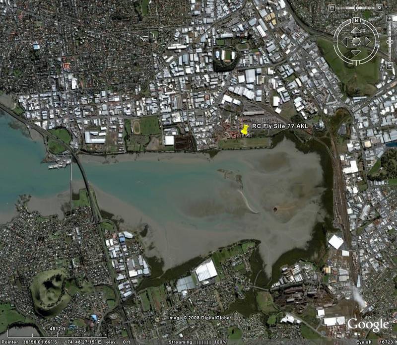

Joined: Feb 2006
Posts: 720
From: Brisbane Qld, AUSTRALIA
Default RE: Power Decrease Using Exhaust Deflector.
Harry,
Interesting point.
I havnt tried a straight pipe extension, only the bent silicone extension.
I will look out for a suitable straight pipe and try, as i would prefer to port the exhaust further away from the Fuse and tail.
Ive also wondered what effect an extension pipe with a larger diammeter hole. What effect would a pipe two times the diameter of the muffler exhaust have.
Wheres the flying site in AKL.
I was told (by a non model flyer) it was around here.
