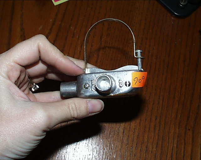

hi guys! weird questoin of the day...what IS this strap on muffler? does anyone recognize it? i thought the 3 outlets, none of which have been drilled open yet, was particularly interesting.....

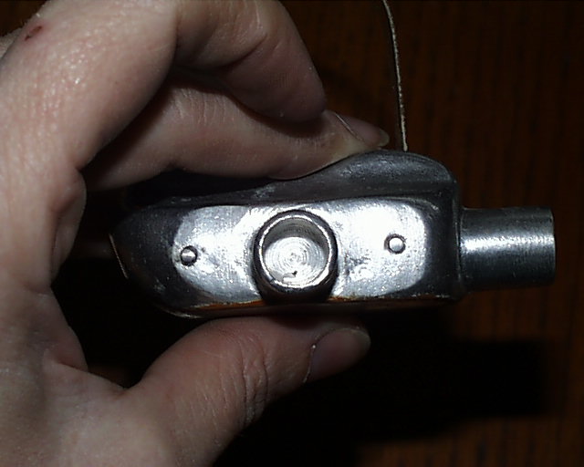

You guys have beeen sooooo great at ansewring these oddball questions in the past, hope you can help again this time. heres another pic in case it helps....

Thats an old Tatone strap-on universal muffler, Designed to fit most all brands in a particular size range. The strap goes around the cylinder to hold the muffller on. You just drill out the port that directs your exhaust wherever you want. Used to be the only alternative to a stock muffler, & a way to put a muffler on a motor with no mount provisions.

given that the exhaust port is roughly 1" x 5/16" then would that make this roughly a .25-40 muffler, i assume?

Friend of mine is currently using one on an old small case Super Tigre 60. It works well as an exhaust diverter and provides adequate back pressure for idle, but it doesn't muffle.

I still have one and used to use it several years ago. After you drill out the port, a common hose from the auto parts house is held on with a regular screw clamp to direct the exhaust where you need it to go.
I had to make a gasket out of some sealer to keep it clean, and it works fine.
Not quiet, but fine all the same.
