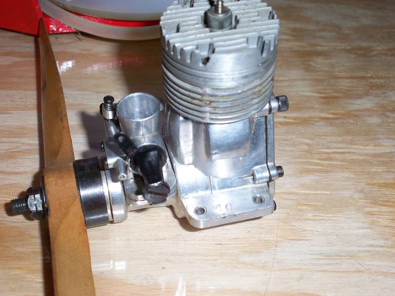

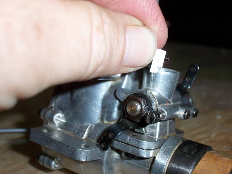

need to know what type engine this is and where i can get a muffler and a small piece for the carb that is broken?the only writeing on it is 40 [img][/img]

It's an older Fox engine.

Looks like it has an early Eagle carb on it...that might date it sometime in the mid to late 70's...(the fuel line nipple is smooth/no "barb" on it )
Is the piston ringed or is it an ABC type?

not to familar on how to tell that (kinda green at this) but looking thru the muffler hole there appears to be a ring at the top of the piston i got this engine from a friend of mines deceased father inlaw i helped him move some stuff and this was in the go to the dump box it has great compression i would like to get it back together and put it in something!

I kinda figured it was ringed...
That broken off piece looks like the low speed stop screw...I think you could run the engine just fine with that carb just the way it is...just adjust the low/idle speed with your throttle servo trim.

Looks like a 1973 Fox 40. I need a Carb part same as on your engine. Wood you consider selling Carb or engine??

You can buy a new carb from Fox Manufacturing that will fit your engine no problem. All of their flange mount carbs are interchangeable between the 40,45, 50, 60 and 74 engines.
But besides that looks like your idle stop or idle speed adjustment piece that broke off. it won't affect the operation of the engine. I haven't used that adjustment in like 30 years now anyway. I use the throttle channel trims or end point adjustments for idle speed via the servo.
So you don't need to fret about it much.
