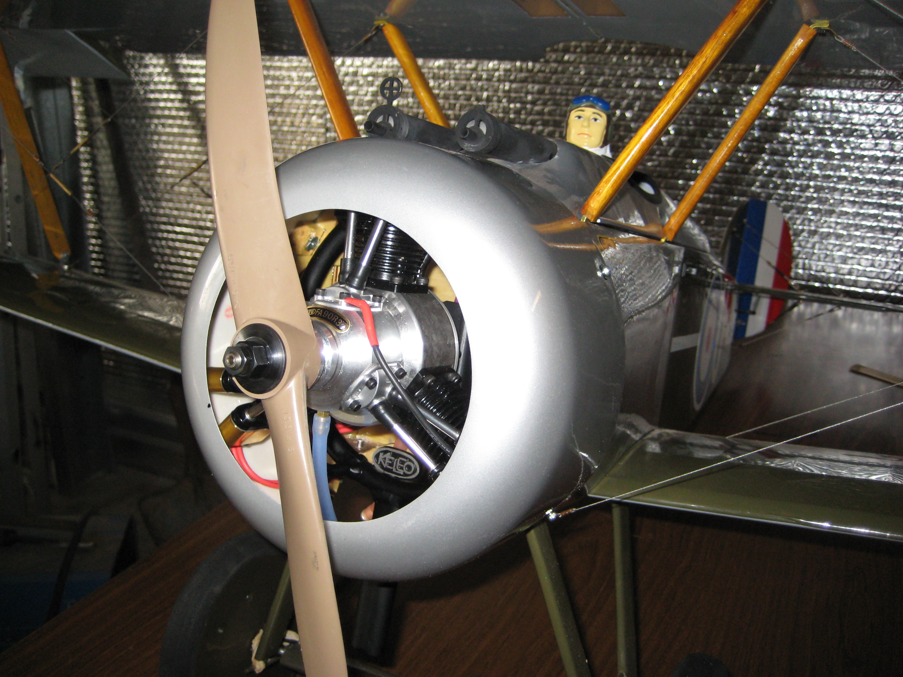

Sorry - I missed the question about four stroke vs two stroke so here's my two cents worth on that subject. Two strokes develop their peak power at higher revs than four strokes and generally, if you want a fast model, go for a two stroke. Four strokes are more torquey than four strokes - that is, they develop their peak torque at relatively low revs but will swing larger props at those revs. For scale models they also sound more like the "real thing" They also use less fuel and make - to my ears - a more pleasant sound (not that a Nelson 40 on its 7 x 7.25 prop does not sound good). I am also told that their throttle response at mid revs is better and so are popular in 3D applications. They are also happy to work in their mid range and near idle without protest for long periods once set up correctly. The sight and sound of a Laser 150 gently ticking over at a low idle for an extended period and then roaring to full power just has to be seen to be believed. The big Saitos and OSs will do this too when set up correctly. The Laser will happily do it with no nitro.
But
Four strokes are far more expensive, are far more complicated and as a result, require more maintenance. They have tappets to adjust (apart from RCV engines), they are usually ringed and will eventually need a new ring. They do, however, last a long time. I bought a Saito 45GK second hand, used it for a year, sold it to a bloke who used it for 10 years and then I bought it back and used it some more. It eventually needed new bearings which I fitted and I then gave it away to a young kid who is still using it some years later. When pulled apart after about 12 years use, it still showed the hone marks in the cylinder but even then did not need a new ring. It is now close to 20 years old and still running fine.
As a result, most of my engines are four strokes. I have a couple of two strokes in trainers and in a stick but the rest are Saitos and OSs in scale and semi scale models and one lone ASP 61 (very cheap and very light) in a Goldberg Cub. For my kind of flying, it has to be four strokes.
The two pictures are of my Saito 90 3 cylinder radial nestling in its Hanger 9 Sopwith Camel and a little Saito 30 mounted upright in a Phoenix Tiger Moth DH82a (to look a bit like the engine in a DH60 Cirrus Moth). The Tiger Moth has been flown several times recently and flies really will with the undersized engine and the Sopwith will get its outing once the August Westerly Winds die down here.
But
